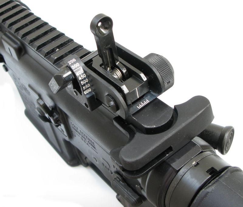

Next Up: mount and zero the MaTech rear BUIS - which is what will stay on the rifle most of the time. That was a piece of cake. If you don’t own one of these, you should. It was the easiest rear sight to adjust I ever worked with. The front sight was already copacetic from zeroing the carry handle sight, so I didn’t have to fool with that. And the MaTech rear sight allows adjustment for both windage AND elevation. So if your front sight post is properly adjusted, your done. I simply set the elevation knob to the zeroing mark between the 300 and 400 meter marks, verified that elevation was spot on, and then adjusted the windage knob a couple of clicks, and BINGO! I was dead center for a 300 meter zero. Here’s what the MaTech rear BUIS sight looks like:
