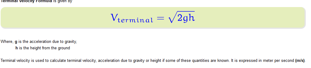

Well, I found this but it's Greek to me!
Chas.
Chas.
This is the formula for Terminal Velocity in a vacuum. Hence it only varies with the height and gravity. In a vacuum the bullet would return with exactly the same velocity as when fired (if fired perfectly vertically at < escape velocity). This ignores friction of the atmosphere, which practically limits falling objects to about 120fps if they don't have any downward velocity to begin with.
The bullet or the penny will be highly unlikely to penetrate the skull with their vertical velocity.
While I don't work as a Physicist...I DO have a degree in Physics and ballistics was within my course of study... :lol:
Okay, now we're getting somewhere. Using 120fps as the velocity in the muzzle energy formula of (V2/450,000)*Wt. we get (14,400/450,000)230=7.36 ft/# energy for a 230gr. 45 ACP. The impact energy would be half that for a 115gr 9mm round. I don't see those figures as allowing the projectile to penetrate a skull.
I bet this is less energy than the muzzle energy of a Daisey Red Rider BB gun. I think I'll try to find the velocity and BB weight to calculate this number.
I still don't shoot in the air to celebrate, but I'm curious about this falling bullet theory.
Chas.
