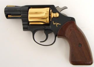

For over $300, maybe you should try some gold accents.
http://www.collectorsfirearms.com/admin ... emID=29518" onclick="window.open(this.href);return false;
doc540
Posts: 1213
Joined: Sun Dec 30, 2007 10:37 am
Re: Van's Cold Blue: Colt Before & After
Post by doc540 »
:cheers2:
They're proud of their blue jobs, ain't they?
And that's not ever for the Royal Blue treatment. :eek6
