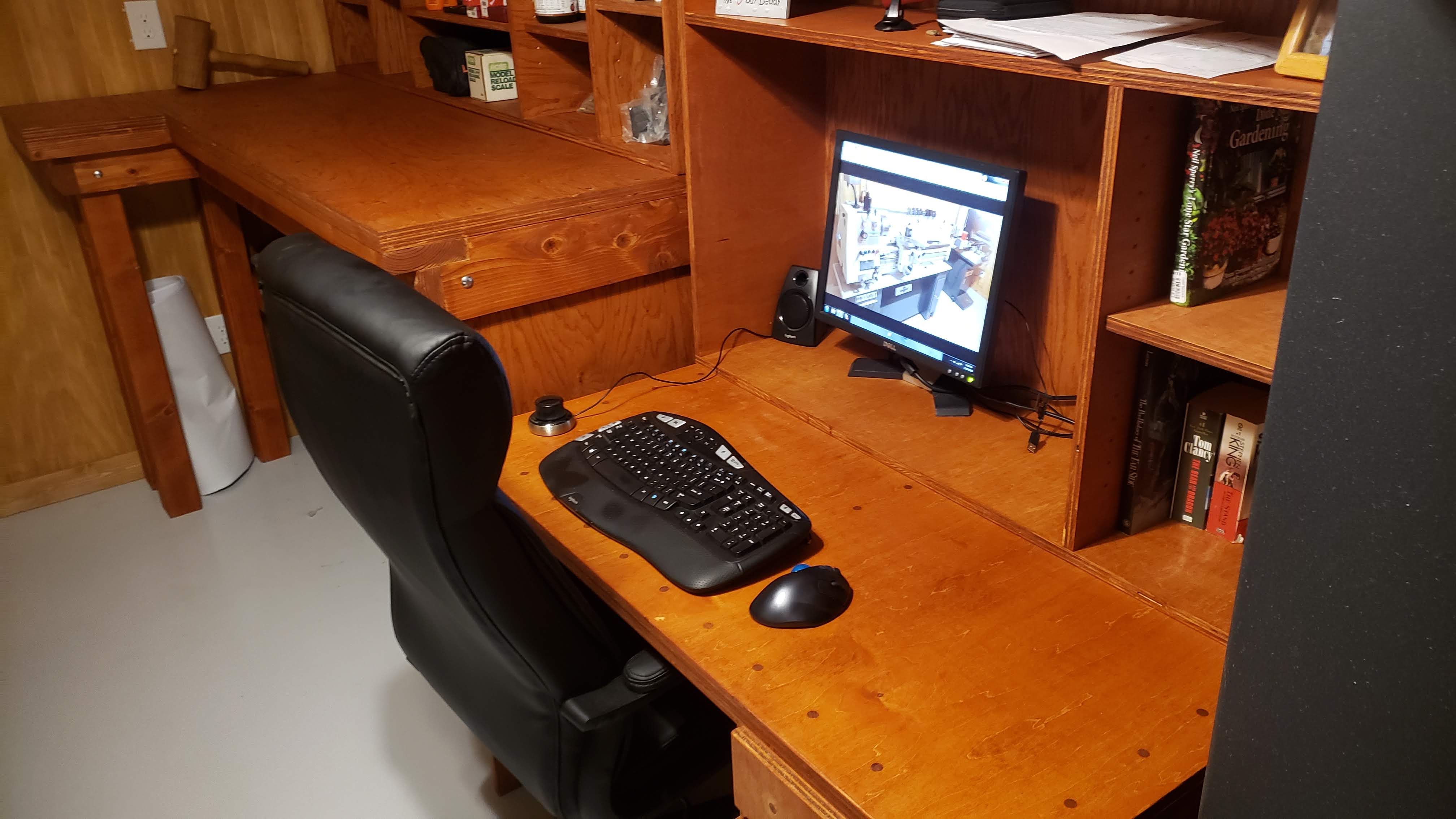

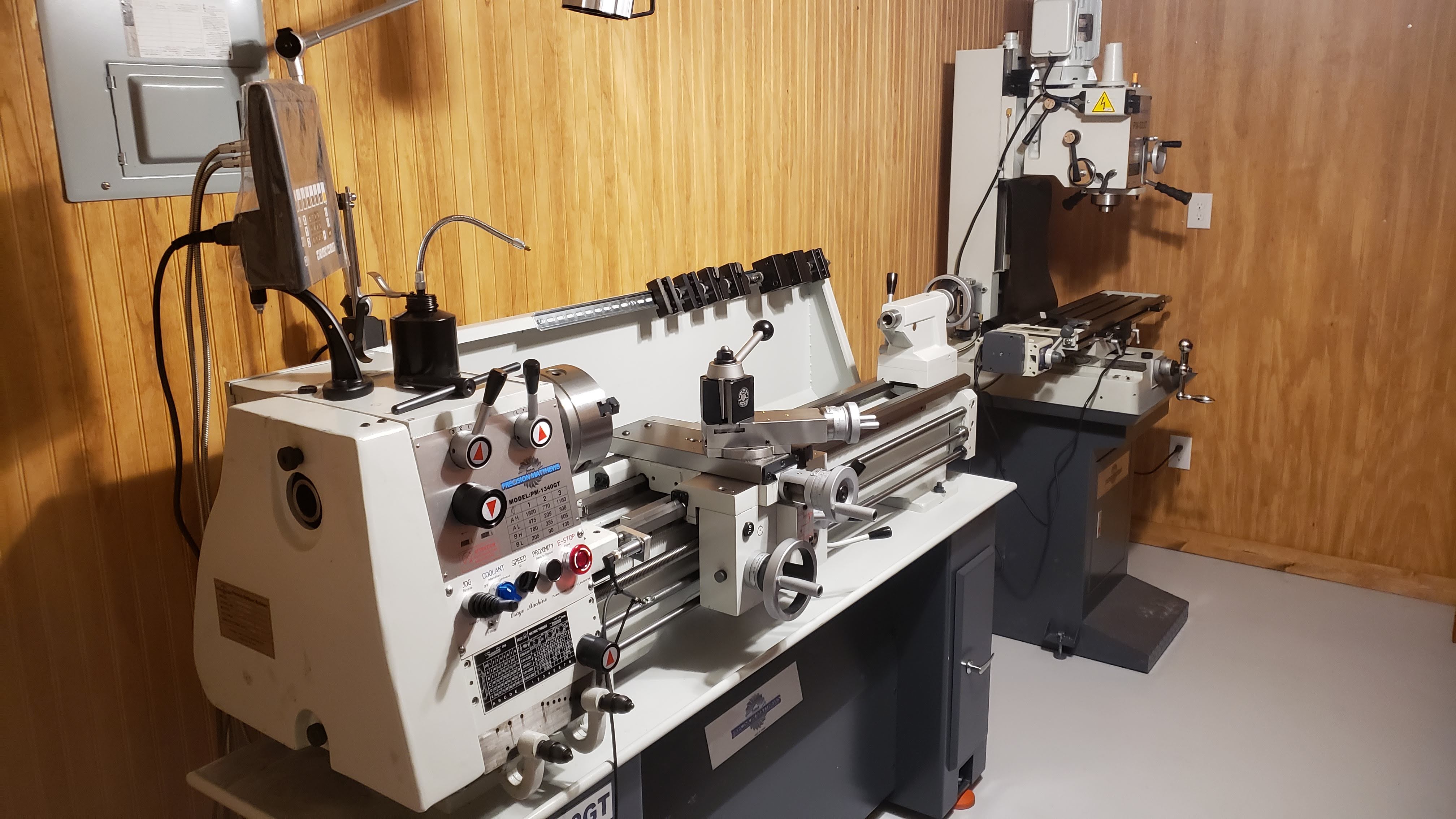

Since I last posted on this thread, I have finished the desk. I spent several weekends picking up a tractor and farm truck and getting them running. But the big thing is my toys showed up and I have been putting them together. I still have some unpacking and organizing to do. Plus I pulled the press out of the box it's been living in for a decade and she needs to be cleaned up and possibly repainted.

Here's the toys.
