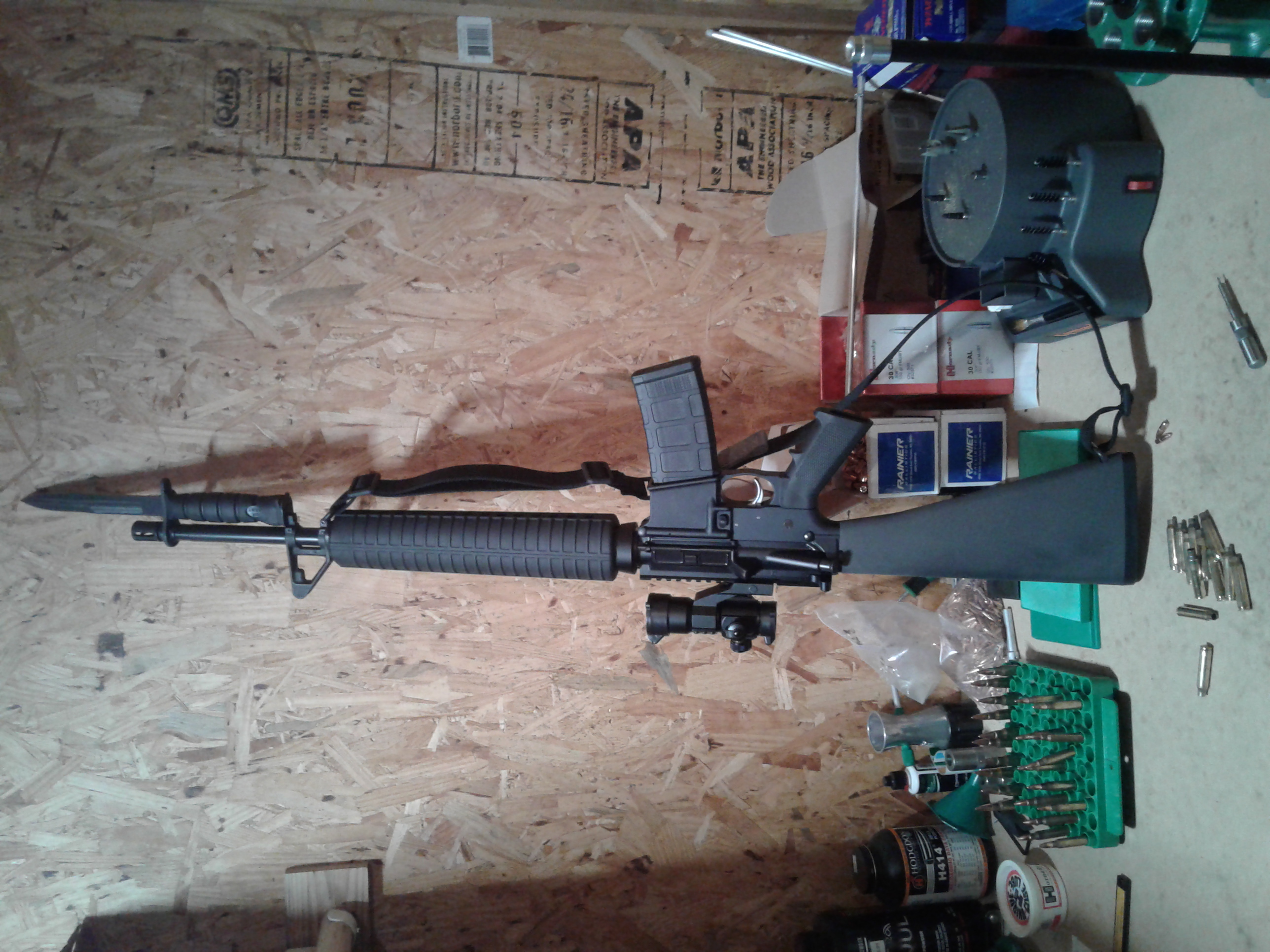

Re: I Want to Build A Rifle.
Anderson lower, PSA 20" upper, 1/7 twist
