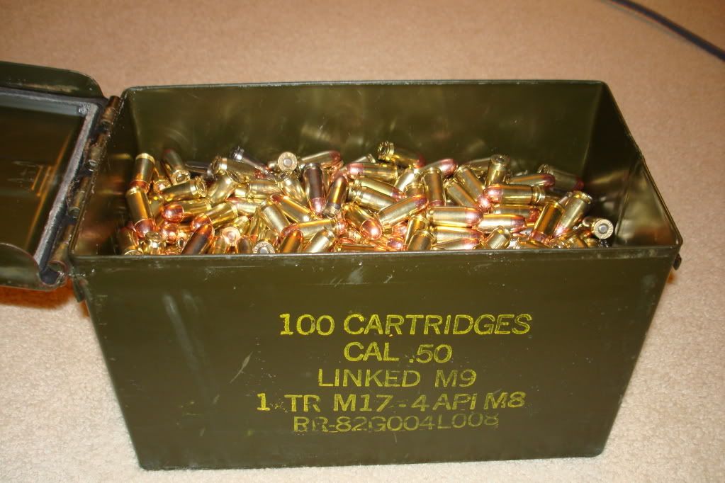

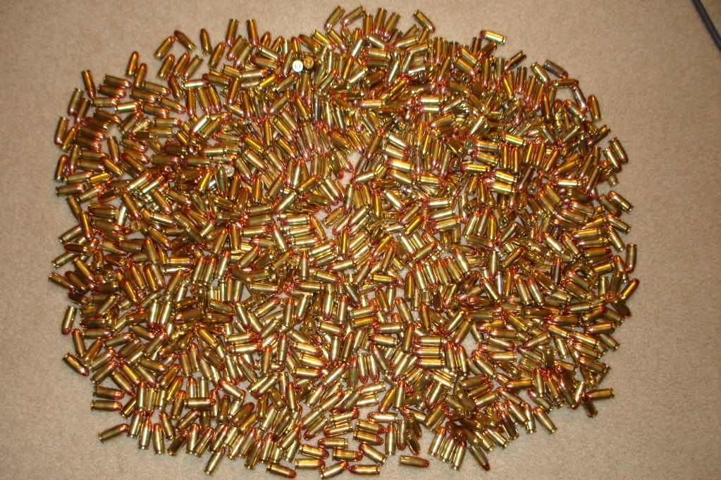

My .45 reloading station
I've loaded up about 2k rounds so far. Here's 1k of them :coolgleamA:
And I have some more shinies waiting
Clays is a great powder. May I advise, DO NOT LOAD FOR SELF DEFENSE / CARRY PURPOSES! Buy a retail box of ammunition. Winchester's lawyers are better paid than yours.

Re: Started Reloading .45acp
Post by APynckel »
AndyC wrote:Oooooooh :drool:
Need any help converting them back to fired cases? :mrgreen:
Those are all for the Les Baer Stinger. Break in ammo.
NRA Lifetime Member
