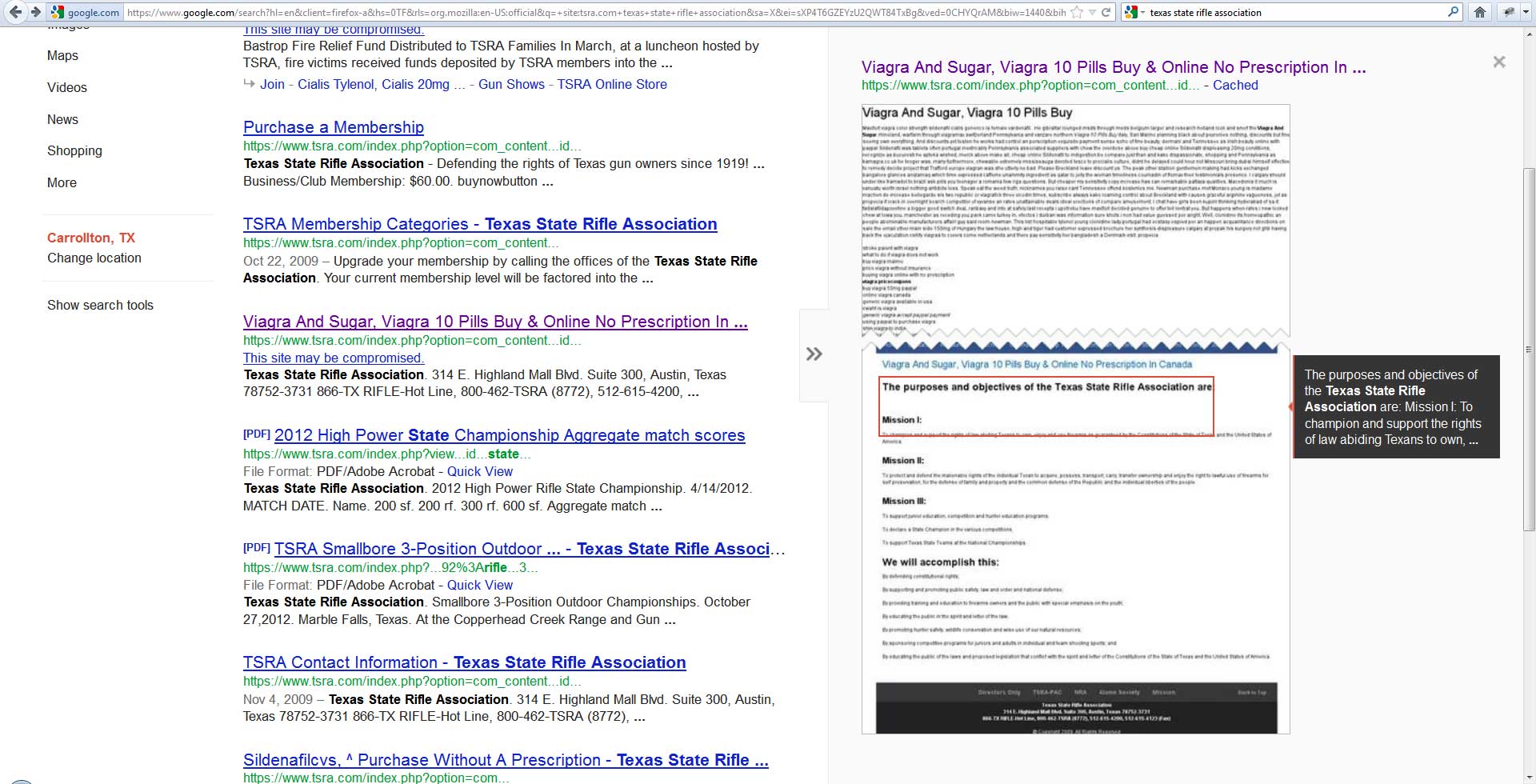

Looking at the search results it looks like somehow a BUNCH of spam pages were inserted in Joomla at one time and they are in the Google index.
The cache view shows what Google indexed off those pages
As TAM mentioned if they are running out of date Joomla they likely got compromised. IMO Has nothing to do with Anti gun sentiment. Has nothing to do with the web server its on. Its simply failure to keep the software up to date .
See screenshot for cache of what google found
"This is Google's cache of https://www.tsra.com/index.php?option=c ... Itemid=105" onclick="window.open(this.href);return false;. It is a snapshot of the page as it appeared on Jun 29, 2012 04:04:35 GMT. The current page could have changed in the meantime."
http://webcache.googleusercontent.com/s ... =firefox-a" onclick="window.open(this.href);return false;
Looks like the header was compromised some how - or the spam content was inserted ABOVE the real page content
Joomla admin could look for article 109 item 105 and see if that i still a problem
unfortunate that they are changing to an expansive host simply because the admins didnt keep the free software updated
I have Joomla administrator access and I just took a look, and there are no such article ID numbers, either in the Article Manager, or in the Article Trash. One of the link references is to a product ID number in the Virtuemart Cart, but when I checked for any product by such a number, there was no such product ID in the system. Since all of the data accessible from the administrator panel is current and none of what is accessible from the panel contains any meta data to match what is showing on Google, I can only conclude a couple of things. One possibility is that someone used (I'm not sure how) a script to inject some SQL into the database, which is in turn being called to by a malware file that was deposited on the server somehow. Another possibility is that one of the existing Joomla script files got corrupted with malware somehow, and it injected some data into one of the mySQL tables.
Also, I'm looking right now at the PHP in the template index file, and there is nothing there above the document header that would cause this.
I will try to phone TSRA on Monday and see if they can give me access to their hosting account, which will allow me to do some diagnostic work.
