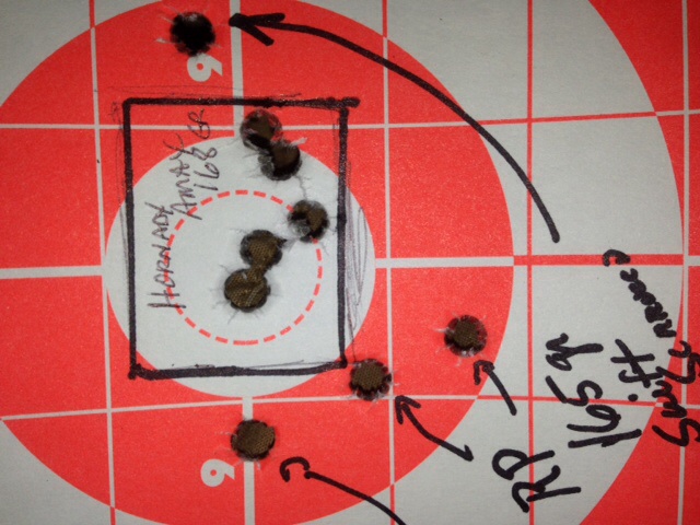

Donf
Posts: 4
Joined: Sun Sep 12, 2010 9:02 am
Re: 700 sps tactical 20+ inch group at 100 yards
Post by Donf »
I have the same SPS , and the ammo makes a huge difference. The tight group is 168 grain hornady AMAX, the loose shots are Remington accutip 168 gr swift.

multiple68
Posts: 21
Joined: Wed Apr 10, 2013 11:06 am
Post by multiple68 »
As an update...I was finally able to get my groups down to sub MOA. Part of it was definitely the ammo, but I think I also needed to just get more rounds through this particular rifle.
I did "shoot the box" as was suggested by TAM, and got nice results. This was after I got shots placed in the middle of the target.
Got a deer with this rifle a few weeks ago...right through the lungs where I aimed.
