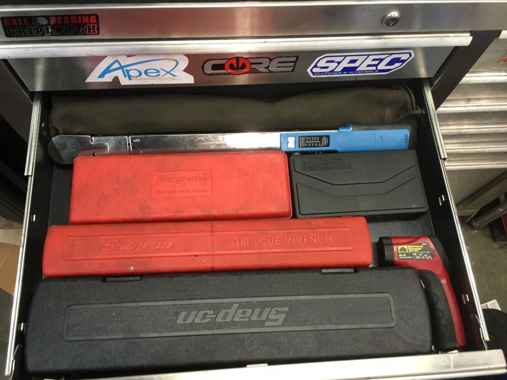

Im a mechanic, not a gun smith, but there are parallels.
A common statement I make is.. "Why is it, folks can not afford to do it right the first time, but always seem to have the time and money to do it a second time.?"
a TQ wrench (or screwdriver) is a good idea... but ONLY if it is calibrated, and reasonable quality....
The fasteners your talking about are very low TQ, and a torque wrench that is not calibrated, or of sufficient quality so as to be repeatable is not a good idea.I buy and treat my TQ wrenches like I do guns... I do not own a high point .... I do not own a Harbor Freight TQ wrench.
The main TQ drawer has nothing but certified Snap on or Precision instruments TQ wrenches .. The second drawer the same and a tq screwdriver.
In many cases it would be better to do it by feel, then use a low quality, uncalibrated TQ wrench.
