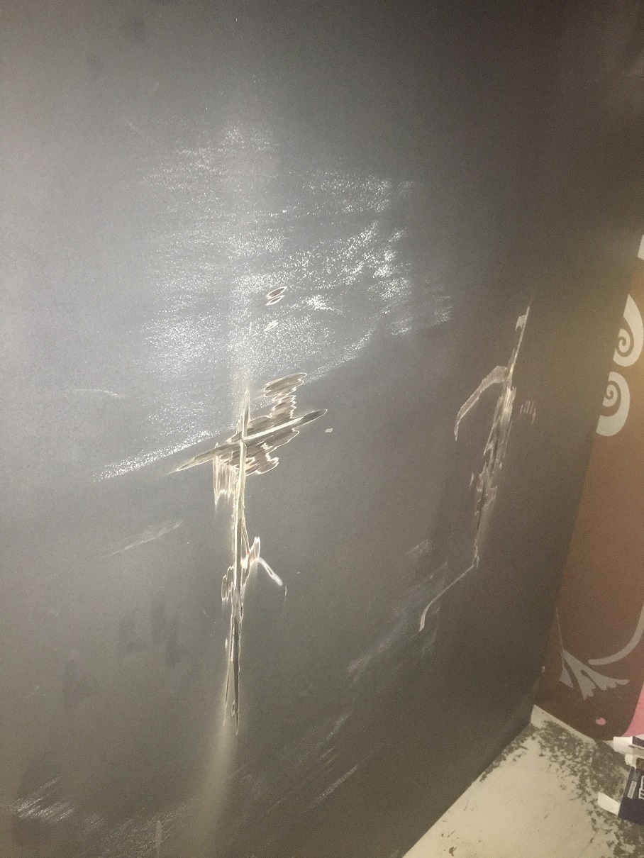

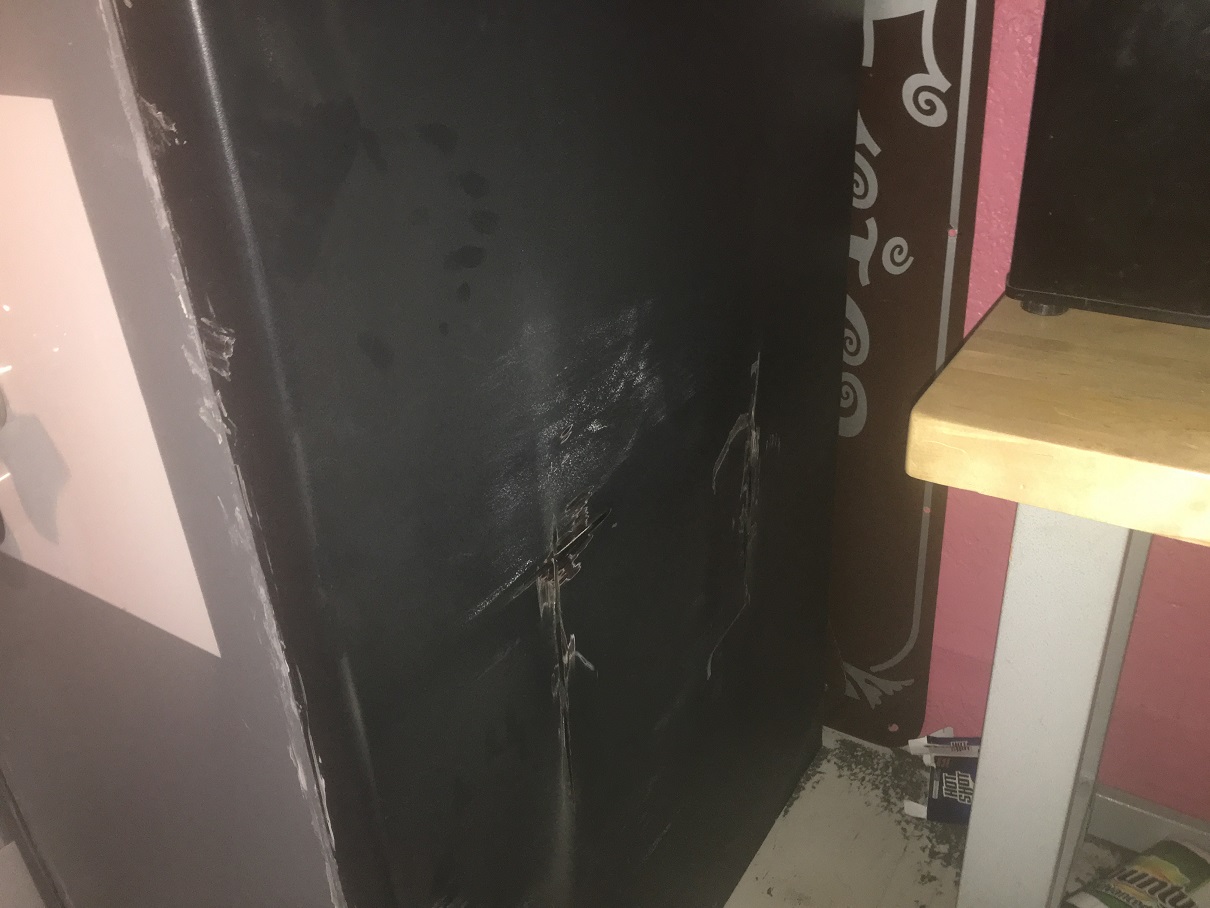

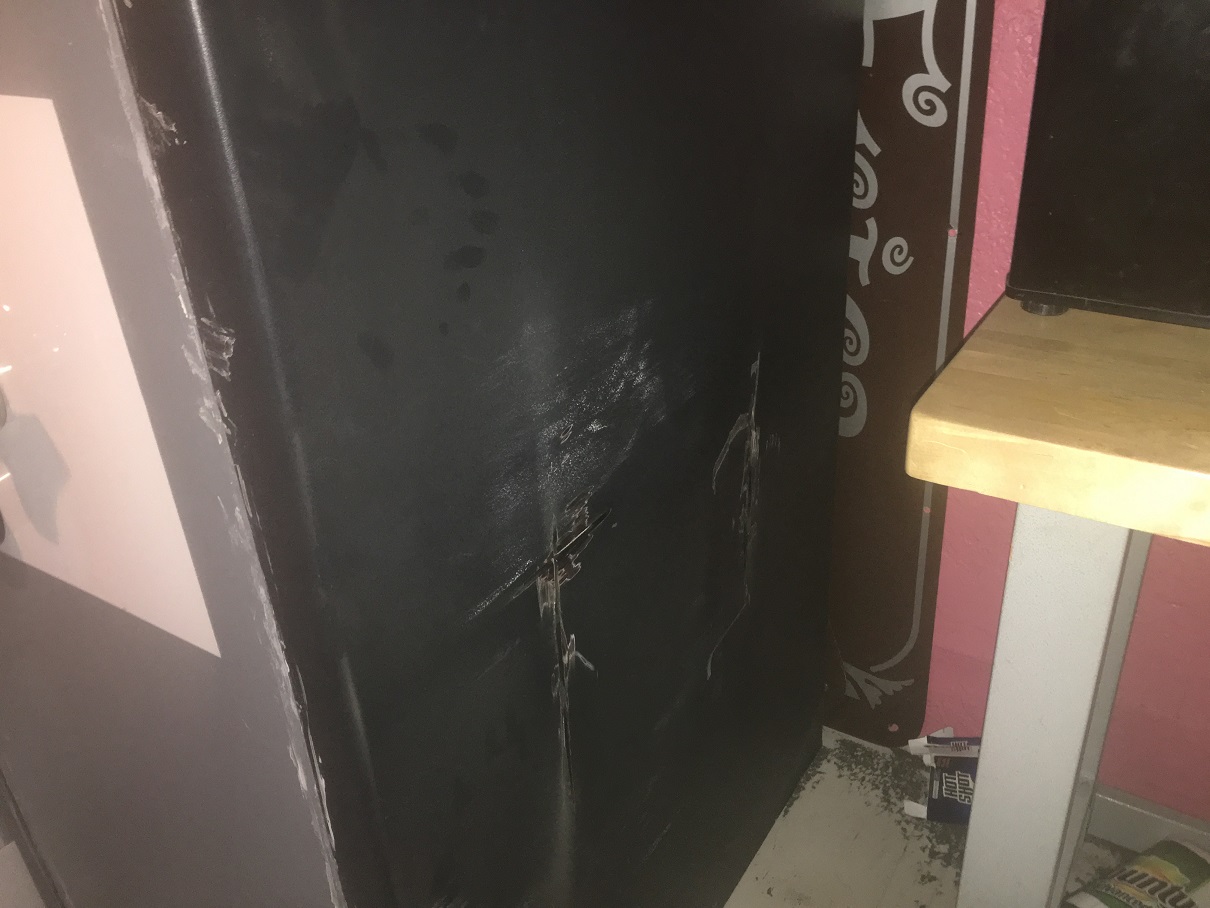

We were awoken to a call this morning around 6:00 am from the alarm company. The motion sensor in my wife’s store had triggered, and the police were on the way.
I dressed, armed, and left for the store. I got there in time to meet HPD. We entered together, and I turned off the wailing alarm to the smell of freshly cut metal.
Three holes through the roof / one through the back wall/ and several large cut marks on the side of her safe were all we found. Nothing stolen: not the flat screens, nor the PC, nor any of the (only silver) product in the display cases. The safe holds the high dollar stuff, and it earned its hefty price tag many times over last night - they had several cuts through the side, but never penetrated the composite filler to reach the inner wall.
We have contractors in the store today erecting temporary fixes, and they will be doing the proper repairs during the week. Looks like I’m sleeping in the afternoons, and spending the nights in the store this week until we get all the repairs completed and a new safe installed.
Not the best way to celebrate the Christmas shopping season at a little jewelry shop, but things could have been a lot worse. Overall, we are blessed that it is only repair work needed, and that we didn’t lose our inventory only two weeks out from Christmas.

This was a TL-30 x 6 rated safe from the Original Safe Company. All six sides of this safe are hardened, as opposed to just the front like you'd find in a typical RSC (Residential Security Container) safe at Academy.ELB wrote:Glad you were not hurt worse. I dunno how these things work, but hope it doesn't impact your business insurance premiums too badly. I imagine for a jewelry store insurance is not one of the cheaper items.
What brand/model safe was it? Was it TL-15 or TL-30 rated?
best wishes.
I was out shopping for a new one today, and I'm going to buy exactly the same thing. I asked the folks at Houston Safe and Lock (where we bought the first one, and where we'll buy the next one) if I could put the two safes side-by-side and bolt them together such that all the cut marks are sandwiched between the two safes.
He said that he didn't recommend that - just put them side by side and forget the bolts. Each safe is over 4000 pounds, so they don't even need to bolt them to the floor - but if he did try to bolt them together, he'd probably ruin several diamond bits just getting one bolt between the two of them. The weight alone is enough to keep them together, and to keep the scarred area of the first safe completely secure.
His recommendation to fix the original safe: Bondo. Upon inspecting the safe, he said that only the outer plate was touched, the composite material between the plates didn't give, and the inner plates never even knew it was under attack. The only thing this safe needs is cosmetic touchups.
