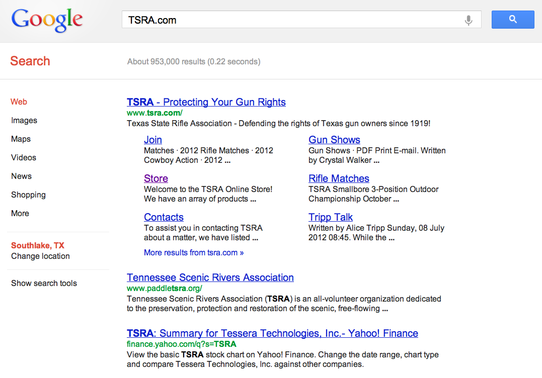

Google is innocent in this case, see the above discussion. The culprits here are criminals who inserted links into the TSRA website that have since been removed. With that said Google wasn't the only search engine providing the results, BING and Yahoo provided similar results. Is google gun friendly? No. Are they Anti-Gun? Maybe, Just because they have made a decision against weapons in their shopping results doesn't mean that they are. That could have been a lawyer induced decision, possibly in an effort to avoid a threatened lawsuit (We probably will never know). They haven't taken down gun related content out of their search results or youtube so I don't really think they are 100% anti-gun.tommyg wrote:I have been hearing stories about google attempting to block out pro gun websites. This looks like one of their attempts

It worked correctly for me. My preferred search is Dogpile.com. They are a meta-search engine that goes out to Google, Bing, Yahoo, and one or two others.

Google has a ton of detailed information on the compromises available to the webmaster. All free. TAM or anyone else who can help fix it can get details from google about what they found in the webmasters tools.
They dont show detail to search users because most search users dont care ( and cant do anything about it ) - they are blindly clicking links trying to locate stuff.
Also showing TOO much info to search users is a BIG security problem. For example if I know how to exploit a certain version of Joomla for example I can use google to find targets running that version. Or perhaps exploited sites are easier to access for OTHER bad guys. Putting a detailed target on the sites is not good either ...

I work at a datacenter, we see this sort of thing all the time. What has happened is that an attacker has somehow gained access to the server or the ability to upload/modify files. Typical vectors of attack:
- Outdated or unpatched software (CMS software, blogs, forums, etc)
- Insecure passwords
- Custom written PHP, ASP or CGI scripts that lake basic security precautions (most common seem to be "form mailers")
- For shared hosting, compromises from another site being leveraged to compromise the entire server or other sites on the server
- Someone social engineered the hosting company to grant them access to the server, somewhat rare
- So called "0 day" exploits, these are really rare

Well somebody fixed it, whatever was causing it:

If you are running on a common CMS platform and don't have the resources available to keep things patched and secure, it is probably worth looking into moving to a managed solution where the hosting provider is responsible for these sorts of things.
Blogs and CMS software are constantly exploited by spammers and botnet creators because it is an easy way to quickly get their malware/scam site pushed up in Google's index for popular search terms and drive unsuspecting people to get their computers hijacked. This is the reason Google flags sites that get hacked, even if they aren't serving up malware themselves. The advent of the nofollow tag has pushed things from simple comment spamming into more nefarious tactics, like injecting the garbage code into the site templates.
