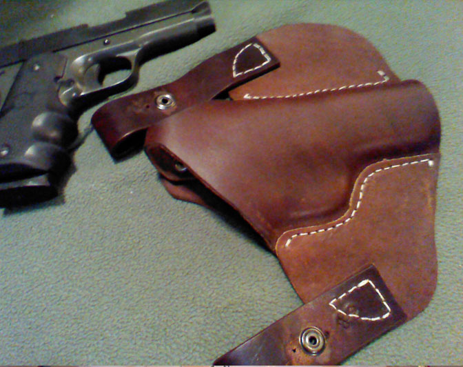

My latest holster for IWB. It started its life as OWB, but since I already had a great OWB I bought a dozen years ago, I thought I'd convert this one. Added the extensions and loops with snaps. The photo doesn't show it, but the loops fold down, of course. It's very comfortable.

I bought all the materials from Tandy Leather. Cost is $64, not including cost of tools. The belt clips alone are $8, Item #1240-24.
