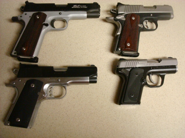

but I like the classic two-tone; it's like my old IPSC Standard gun. Back in those days it was a popular, practical combination - corrosion-resistance on the frame to protect against sweat while leaving the slide blued to minimize glare off the top-end. Companies like Kimber do it the other way around and get it all wrong, IMO.
Andy,I like mine both ways :thumbs2:

AndyC, that 1911 does look really really nice now. I may have to consider this for my Hi Power.
Geez, thanks for bring up yet another way to spend my $$. :roll:
