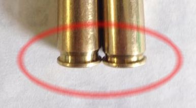

Okay I need a little help.
A guy I work with bought a beauty of an M1 Grande several months ago, then went on the hunt for some bulk ammo to shoot and finally gets a deal on 400 rounds of 150 grain 30.06. Well, he gets his order and the bullets are just a tad too long! My google fu says they are a Greek variant with some mixed reviews.
The casing even looks slightly different and has the markings of H X P 77.
Any idea what this is and what it is for? He wants to send it back but I guess the place he ordered from says it is 30.06 and all sales are final.
Any ideas?

The actual 30.06 bullet can range in size as long as theoverall length is from 2.94 to 3.34 and from the looks of you pic it doesn't look like that big of a discrepancy. It is hard to tell from the pic but the cartridge seems the same between the two., but even then a .02 difference is typically acceptable.

Rim rebate, shoulder length, and case length all look different to me.

Look at the case head. The one on the left is very different from the one on the right. .303 British is a rimmed cartridge, similar to the design of the 7.62x54 Russian. The picture below is .303 British:

It's most assuredly NOT a 303.
303 is a rimmed cartridge and the case is noticeably shorter than 30-06. Just went out and compared the two since I hove both.
Quick google search says HXP 77 is Greek M1 surplus.

He did state it will not fit in his Garand properly and while it is close, it is a different size.
If it was me I would not try shoot it.
Quite, didn't notice that at first. Yea, I wouldn't shoot it.

I wouldn't shoot that ammo in the Garand if it were mine. That ammo is obviously out of spec.

I'd bet it IS .30-06, just... manufactured out of spec. If it's foreign military surplus, I'd not be surprised at all to see variances like that. Looking at the extraction groove, I'd guess the Greek stuff was "modified" to allow a heavier, more difficult to break extractor, as well as moving the walls of the cartridge forward a bit to deal with out of spec feed ramps and the like.
Not sure I'd want to shoot that in a Garand, though; not because of the weird-looking extraction groove, but because it IS foreign surplus, and I don't know their quality control, the powder burn rate, or how much force it's going to put on the operating rod of the rifle, as compared to US military ammo. I doubt I'd have any qualms shooting it in a quality bolt-action, though, especially not one built off a Mauser-style action.

HXP is what the CMP is selling. I got 400 rounds of the stuff from them a while back. I just went and checked, and it compares to the American Eagle M1 safe ammo about like that pic. Problem is, I don't remember if I have shot any of the Greek stuff out of my M1, or just the modern stuff. I'm going to have to go out to th garage and check my brass. Hold on.
