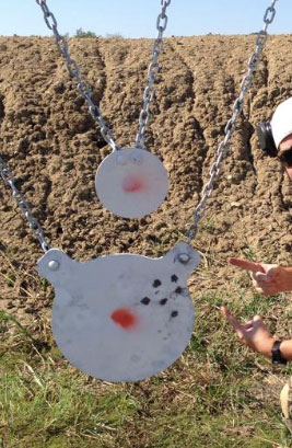

Since it did not happen without photos, here you go:
Handloads:
Factory Federal 180gr SP Ammo:
