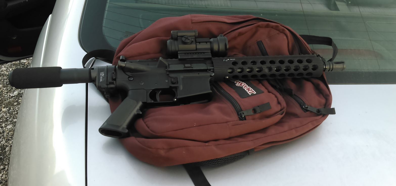

There's an AR pistol in the picture, it's just concealed.
I was wondering how long I should wait until I posted these but I guess I will let the cat out the bag.

What happens if someone mistakenly fires it while the buffer is folded? Is the bolt retained somehow, or does it come flying out to embed in the shooter's face?

Pawpaw, the answer to your question is in blue.
Pawpaw wrote:
jason812 wrote:There's an AR pistol in the picture, it's just concealed.
There is an extension that pushes into the end of the bolt carrier to take up the space of the hinge. When the buffer is folded, there is a tool steel latch that blocks the travel of the bolt. Supposedly all you have to do is close the buffer and cycle the bolt to extract the shell. I would rather not try and will keep it with the mag loaded but chamber empty just to be on the safe side.
When the buffer is closed, the latch is out of the way allowing the bolt to function like normal. You have to push the latch to get the extension in and out of the bolt and it has to be removed before you separate the upper from the lower.

I got the folding adapter from Brownells as it was the cheapest place I could find that had it in stock. Also, for those wondering, yes it is inside the backpack in the first post, not underneath. I need to make a foam insert to distribute the weight from the tip of the barrel, keep it from being loose inside, and protect the gun. I probably will need a bigger pack but it will fit in one that doesn't look "tactical".
In case anybody is wondering the overall length not counting the flash hider is right at 26". Folded is 20.25" long counting the flash hider and about 5" wide where the buffer overlaps the upper receiver. The hinge ads 1.5" to the buffer tube length.
