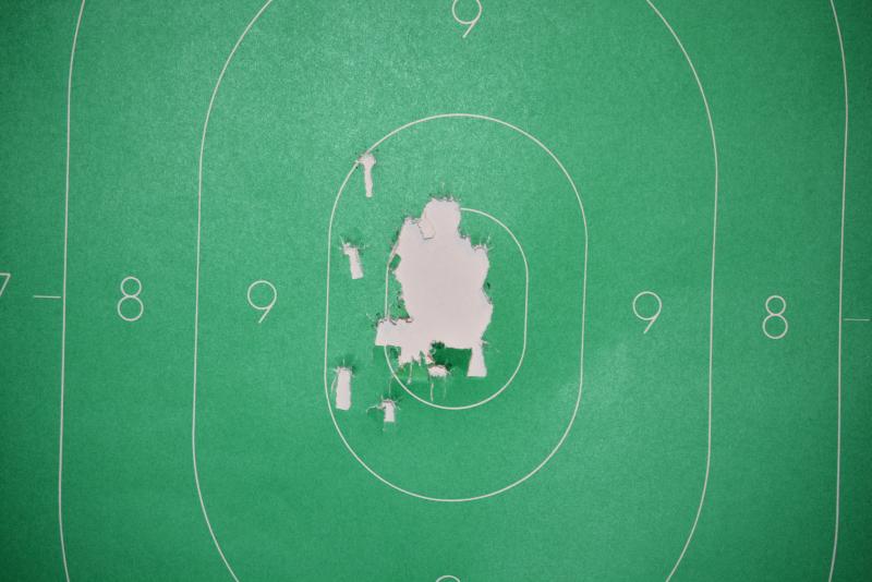

6.0 grains of Unique, using a RCBS Little Dandy.
.45 Schofield brass in a Ruger 4 5/8 inch Blackhawk . 45 Colt.
Hornady 230 grain RN swaged bullet. 7 yards, 2 hand hold off hand.
B 27 target. Seems to be an ok load.
The point being this is the same powder charge as the .45 Auto load Viking1000 talked about, and was thrown using the
same RCBS type powder measure he uses.
