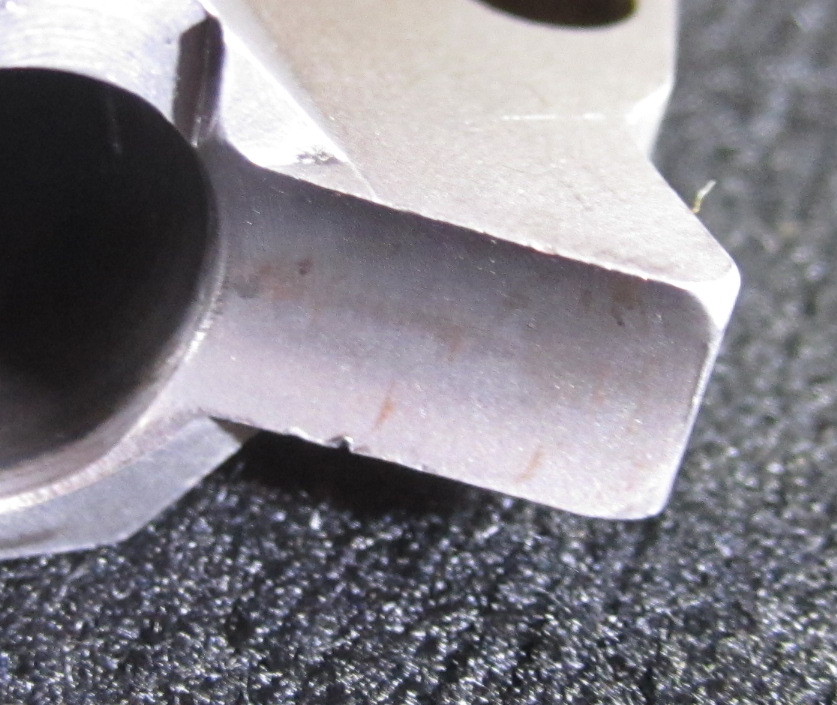

I started looking for suspects. The feedramp has two imperfections. The obvious one, and the one showing up as a discoloration 2 mm down the feed ramp from the chamber. I can feel the discoloration with my fingernail. Attempting to attach a picture for any comments you guys have.
Feedramp close up
Feedramp close up

I have or have had just about every 1911 platform pistol made. Right now I have a total of 22 of them in my safes. They range from a $350.00 Armscor to a $3500.00 Les Baer. I have not had an issue with any of them except the 2 Kimbers. I have put at least 1000 rounds through each of them.
I will say though, that when I get a new gun of any type, I give it a thorough cleaning and oiling. I also inspect them thoroughly for flaws, nicks, & burrs. On some I have polished the feed ramp before shooting.
This same ritual was performed on both Kimbers before they went to the range. I really would like to find one of the "real good ones" because I like the looks of a few of them.
Now, looking at the picture you posted, looks like you could polish the feed ramp, removing the burr and that may take care of your issue.
