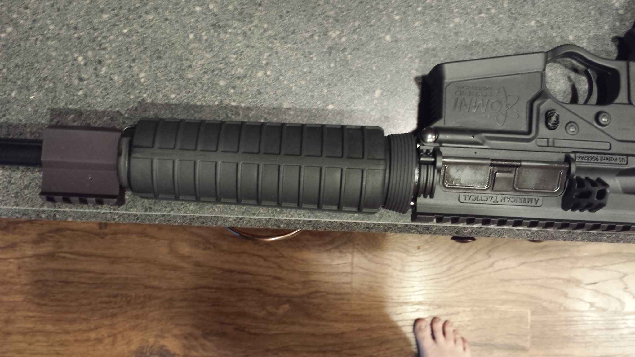

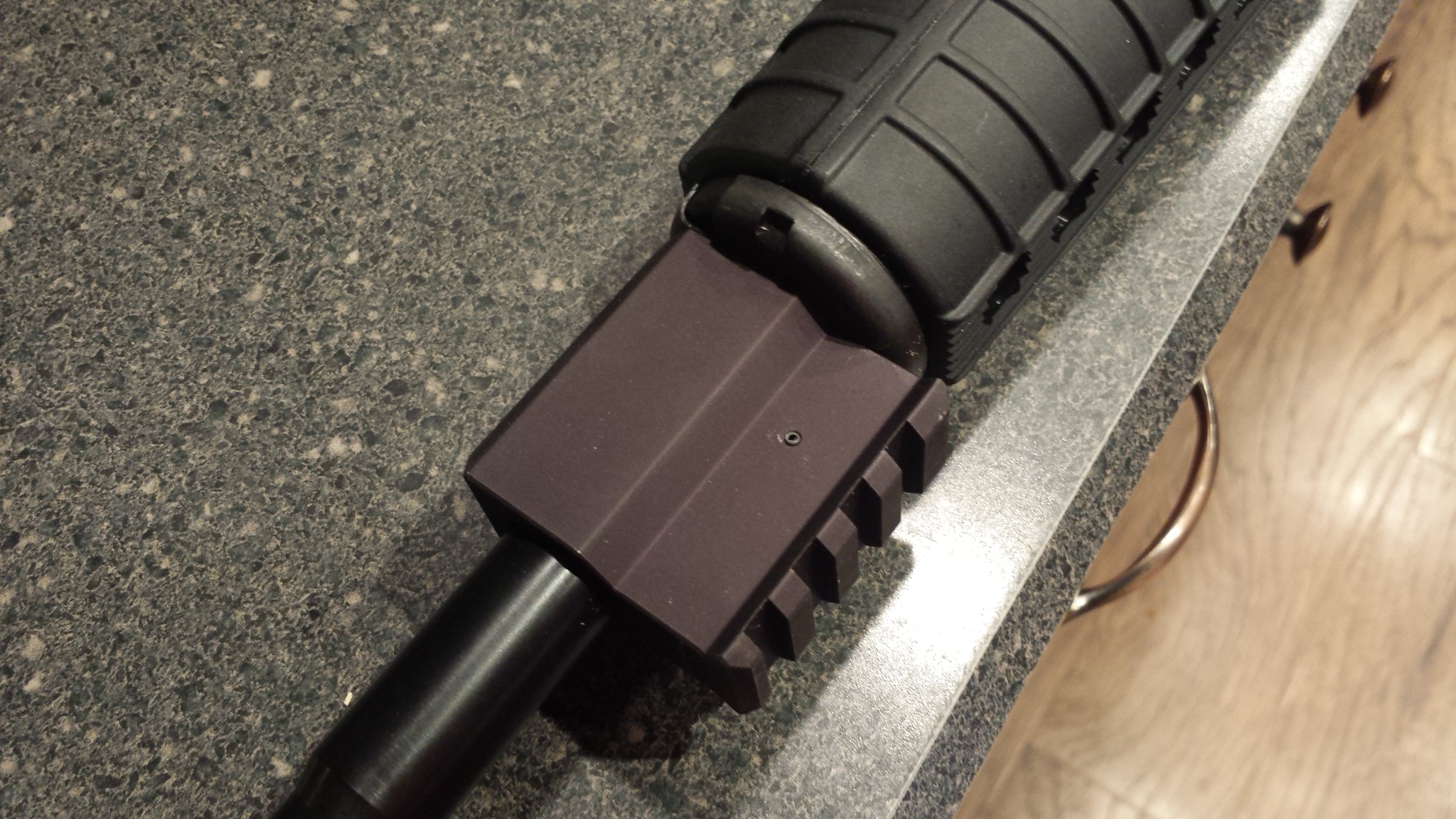

I picked up my first AR for Christmas... It is a very inexpensive ATI OMNI model. When I was looking, I was somewhat aware of issues getting front blocks with rails and finding sights since this didn't have any. I'll eventually put on some mid grade optics, but would like to put sights on first. This has a front rail that is taller than most I've seen. I thought it was receiver height, but putting straight edge over everything, it looks to be about 1/16" shorter (about the thickness of a quarter). I know most of the front blocks are shorter than that and use a different front sight for a regular height gas block. Would I get a same plane set and hope there is enough adjustment? I know I need iron front sights because of heat. Any recommendations for cheap flip up that will work?

I wasn't looking to replace the block or add a rail yet. It looks like it lines up, but is just a hair shorter. Will there be enough adjustment on a rail pair to handle the 16th of an inch difference?
I added a couple pics to show what I think I'm talking about.

OK, I see what you mean. You don't have a rail system; you have a basic hand guard, with a gas block that has a short section of rail on it.
My guess is that there are front sights available that have a little extra height in them to make up for the difference. But without a sight that makes up the difference, yes, it will impact your sight alignment. Being a 1/16th of an inch off at the gas block might translate to several inches off at the target. Now, you can raise your front sight post to compensate, but you'll have that much less adjustment available to you for subsequent elevation changes.
