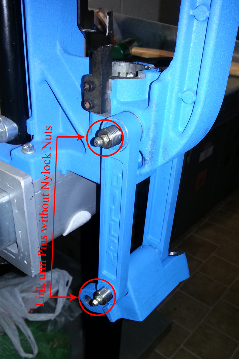

The newer models have grease zerks on two of of the rods, but mine has only VERY small holes. I never considered that one is supposed to get grease in those holes. It turns out I was right; grease isn't going in those holes! I called Dillon today to see if the zerk fittings and bars are available as an upgrade. They are, but at about $45 each for two machines, it would be easier to unscrew the nuts and pull the bolts out so they can be greased. I had decided to do that but I wonder if I could drill the small holes to accept zerks. Has anyone done this with a 650? Also, is there a standard size hole and thread for zerks?

If not an actual pic, can you point out the part number? and location of the current "hole"
https://www.dillonprecision.com/xl650-parts_8_45.html

Are these the upgraded pins and grease fittings?

Yes. My machines have two small holes in the lower arm housing and one on the top. The right side hole on the lower housing is partially visible in the photo, but unless you know what you are looking at, it's hard to see.E.Marquez wrote: Are these the upgraded pins and grease fittings?
Chas.
If so, sure you can drill and tap that and put a zerk grease fitting in it...likely an angled one for ease of connecting the grease gun
