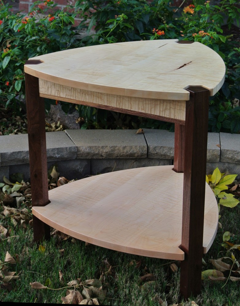

Here's one of a pair of end table I finished a few weeks ago. Made from quilted maple and walnut. It's my opinion that maple and walnut go together like peanut butter and jelly.

Beautiful
