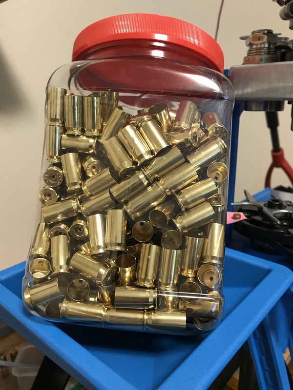

Once, I saw the first batch out of my Arsenal Rotary tumbler, I never looked back. I used Hornady Ultrasonic cleaner before, now it is collecting dust unless I need to clean some gun parts.
I have both SS pins and SS shreds, both works very well. If you clean straight wall pistol cases just stick with SS pins.

Here is an average batch:

I have to admit that's impressive.

Those in the photo look like factory.
