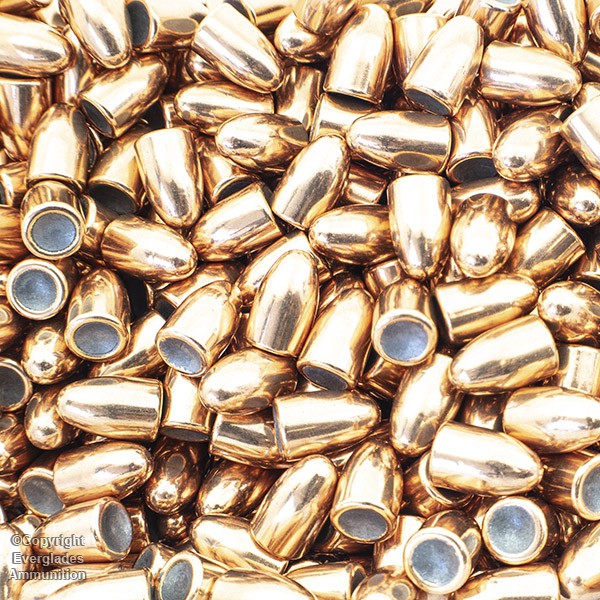

MaduroBU wrote:
Sun Jun 03, 2018 1:34 am
With jacketed bullets, the lead that concerns us is all from the primer.
This is common mistake but not true with FMJ/Ball projectiles as the base is still exposed lead. THe base is the part subjected to the hot gasses and will melt/smoke.
See pic.
There is a great thread on lead on the 1911 forum, including medical testing protocols and real world experience here:
https://forums.1911forum.com/showthread.php?t=349466
If you reload, you can used plated or TMJ projectiles to eliminate this exposed base. JHP's have a jacketed base and are exposed inside the HP, and are c
The bottom line is that to avoid lead inhalation, you should shoot outdoors, with the wind or indoors with PROPER ventilation and practice good hygiene. D-Lead soap is cheap and works very well according to the studies.
I also wear nytrile gloves and have a small fan running beside me when I decap brass before wet tumbling... this keeps the spent primer dust and debris off and away from me.
ETA: You are correct though, in that the primers are the biggest problem
