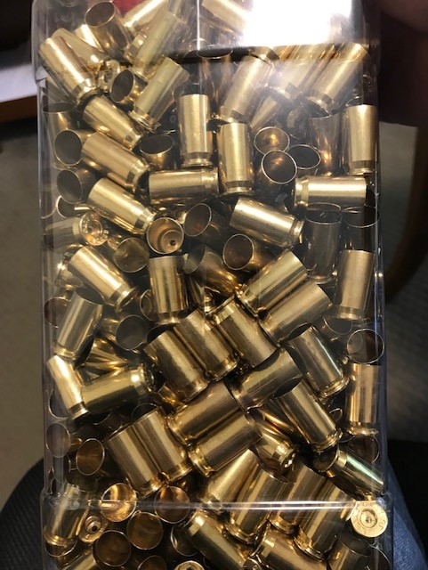

If you'll use Armour All Wash & Wax instead of Dawn, and put a teaspoon or two in the rinse water, your brass won't ever tarnish... I can't distinguish the brass I cleaned Monday, from the brass I cleaned 2 years ago. :thumbs2:

LTUME1978 wrote: Wed Mar 27, 2019 9:29 pm Flechero,
Thank you for the reply but I tried that and it did not work. Not sure why, maybe the hard water that we have here?
Well if you want to try it again just to see... after separation of media- i put brass into a small 1 gal bucket of hot water and add say a tablespoon of AA W&W and swirl around with my hands for a minute. The key is to not rinse it again after this with plain water... I pour out the hot brass onto a beach towel and let a small fan blow over it for a few minutes (hot brass dries fast)
Anyway, here is a container I cleaned way back when I started loading a couple years ago-
