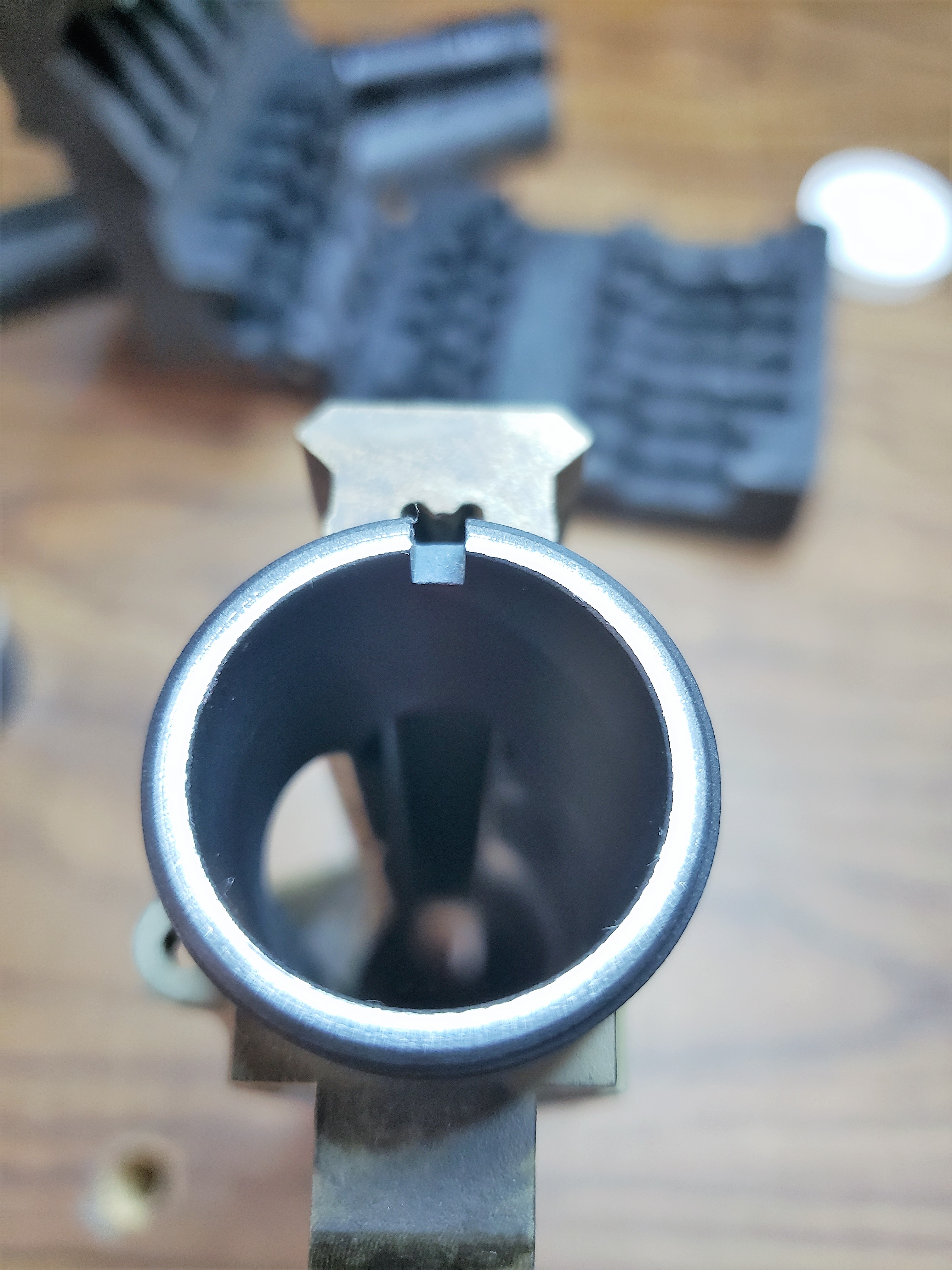

Thanks for the info. If I was planning to do this more often I would probably purchase one of the barrel spline tools. I had not considered barrel clamp in the vice, but I'm going to give that a shot. Now just waiting for the UPS truck for new 9" barrel and Q Cherry Bomb.
Also, I looked into bedding the barrel. Mostly see mixed results on doing this. Does it really make a difference? Would lapping be better, maybe for a precision gun?

I lap all my uppers and have on all the uppers I’ve built. That being said, a coworker or mine went a little nuts on building uppers in different calibers and lengths. He was using the cheapest barrels that he could find like BCA,Anderson,Ar Stoner, Davidson Defense. He had 2 that didn’t group at all, the targets looked like shot gun patterning boards. He was going to junk the barrels and I told him to try bedding them to the receiver first and both of them improved significantly. After that he bedded all of his barrels and told me it improved the groups on most but not all of them.

Lapping tools can make a big difference, they’re cheap, and the work is easy to do. I bought one maybe three years ago, and we’ve used it on each AR we’ve assembled since. Whenever I get around to rebarreling any of the older ones, I’ll lap them for sure if necessary.
Note worth looking into....how necessary is lapping for a machined billet upper, as opposed to a forged upper? Ima hafta talk to my son.
Follow up.... my son says it won’t matter if the receiver is machined billet or forged, the threading that receives the barrel nut is machined, and there’s no reason why a billet receiver wouldn’t benefit from lapping.

Yup, it convinced me to order the Wheeler Lapping kit. I'm about to update my AR-9 SBR, figured that while I had the barrel off...TreyHouston wrote: Sun Apr 07, 2019 2:23 pm Bedding a barrel. I learned something new today!

I ordered the Wheeler lapping kit as I can see the value in trueing up the mating surfaces. It should be here about the same time as the barrel & brake.
