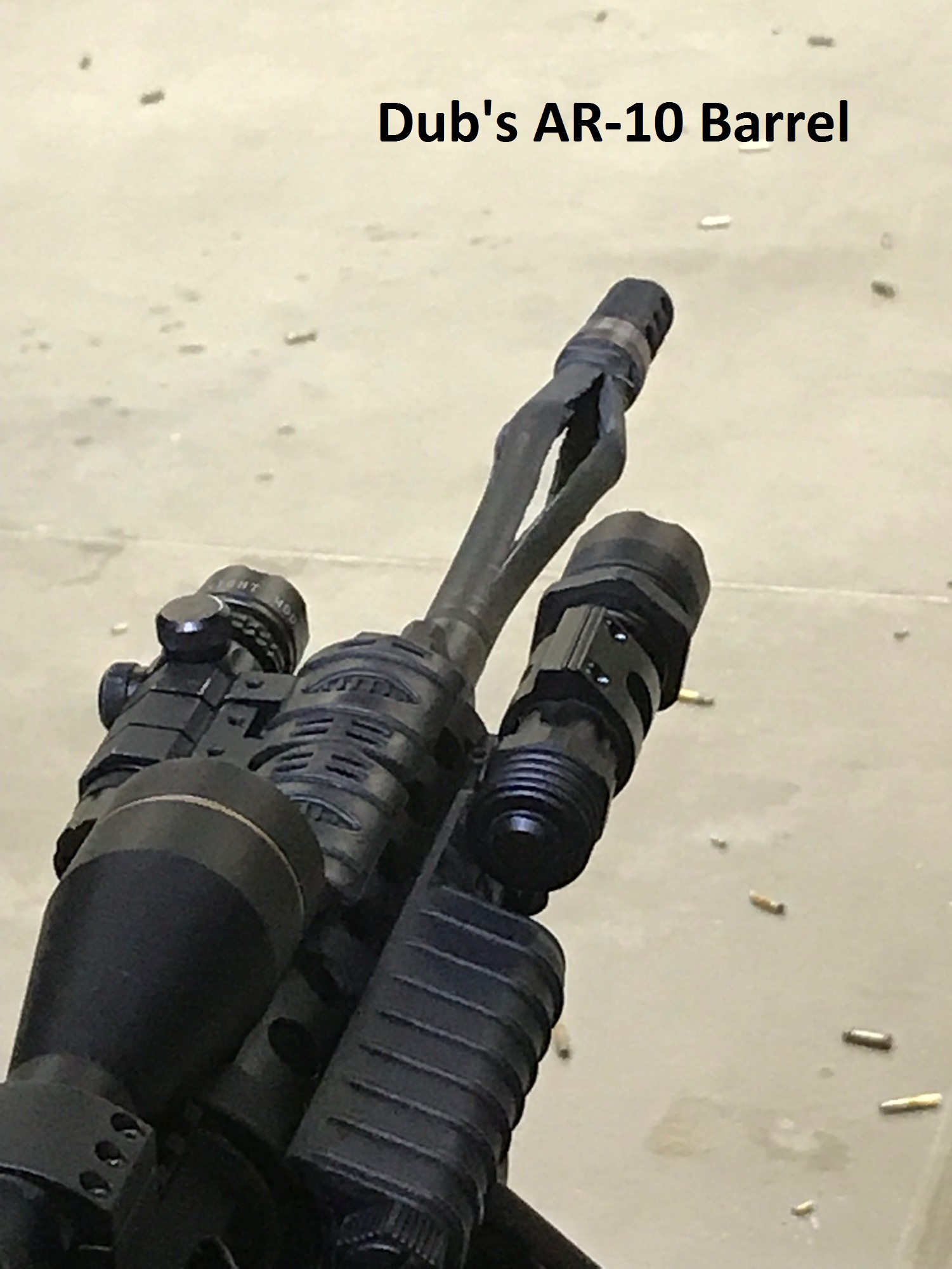

kayt00 wrote: Wed Sep 25, 2019 3:55 pm I had a squib a while ago with one of my 300blk reloads. Same situation, the bullet was jammed into the head of the barrel preventing the next round from being chambered. Was able to knock it out and carry on as normal.
You were fortunate. My Brother wasn't as lucky. No one hurt...but barrel ruined.
