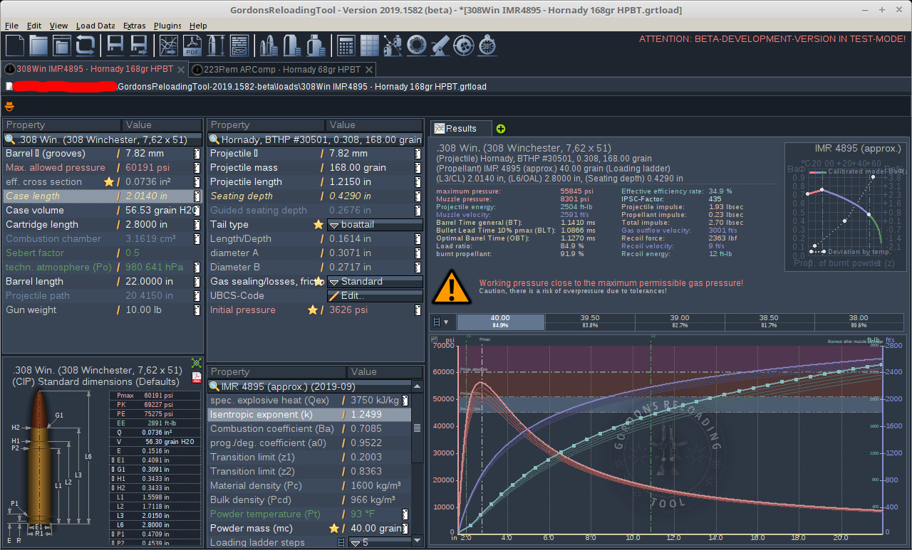

An example screenshot of the main GRT screen.

I just downloaded the latest beta. It is 10X better than the first beta. Graphics as before are very cool. More data are in and more features and it seems accurate. I run my load for 243 but with 4064 instead of the new version IMR 4166 and it very very close to the MV I was seeing. That was with no teaks at all.
This app would have a lot of use by me.
