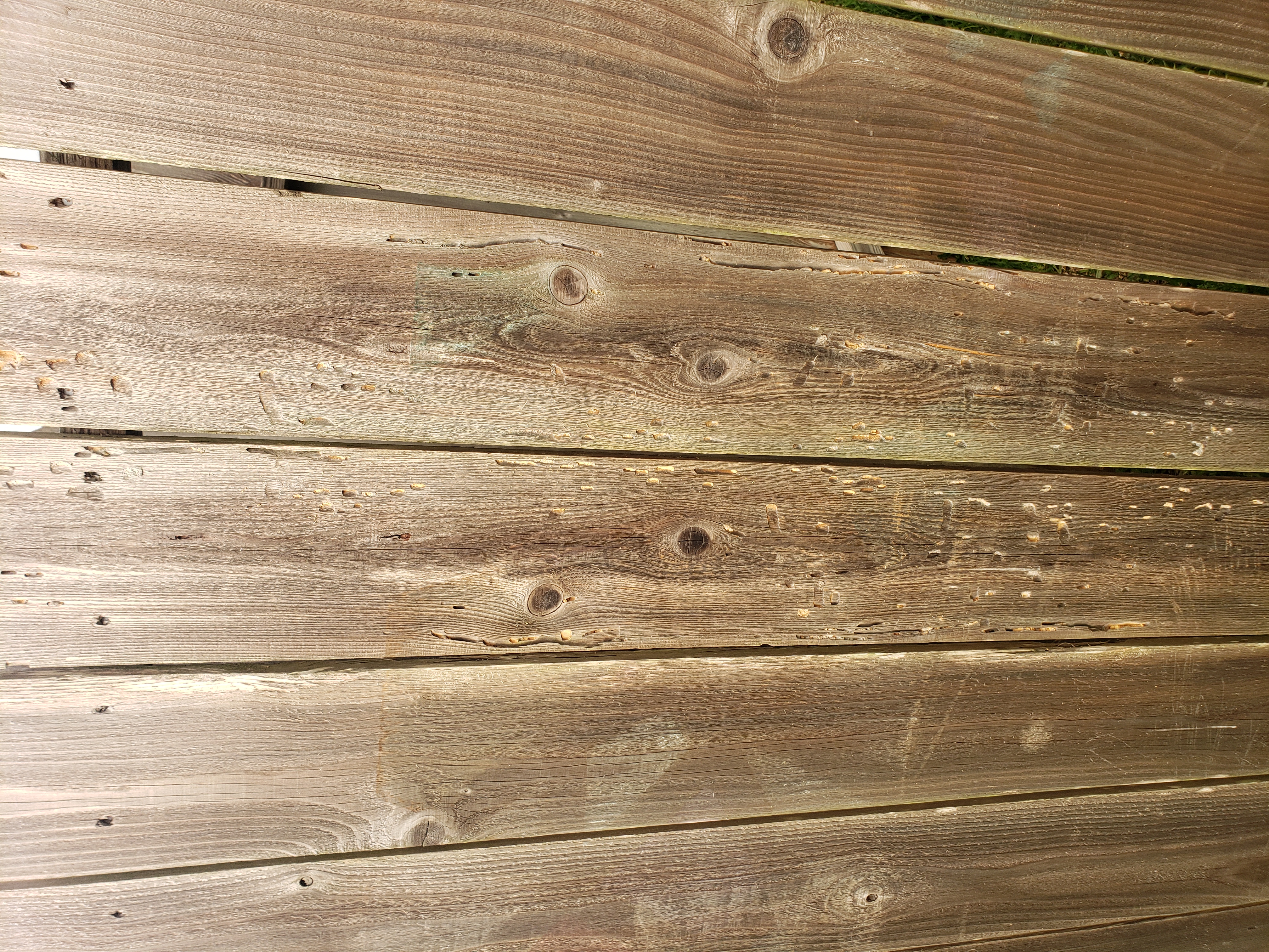

Couple weeks ago my wife noticed termites were eating a couple of our fence boards. We had our pest company come out and take a look.
Turns out they are feasting on several fence boards but no evidence at all that they're inside the house. We got a quote for $1600 to treat the fencing that comes with a 12 year warranty and also install perimeter defense around the house.
This seems high but I know we have a lot of fence to treat and I don't have anything to compare it to. Has anyone else had this done?

I'll snap some pictures when I can get out there to do so. I'll have to ask my wife about what kind they were. I know we're supposed to get an inspection report from the company this evening.
Does it make sense to do the perimeter defense since there's evidence of termites in the yard or should a one time treatment be enough?

They are subterranean per the inspector. The newer looking damage is on a few boards in one section of the yard.

There's also some damage in another part of the yard that looks old
So we've had this before. Probably a season or two prior.
The house was built new in 2017 and we are the first owners. Has slab foundation, brick and cement board veneer.
I don't recall a termite treatment flyer or anything when we closed on the house.
The thing that makes me wonder if this is an upsell job is that there's this long thing in the estimate about conducive conditions for termites, none of which apply to our house. They also tried to sell us on rodent sealing and a bunch of other stuff.
The actual quote is $500 for spraying the fence. Then $1100 to install Sentricon bait pods around the house perimeter and monitoring those for a year.
I got another quote for $1350 from another company for digging a trench around the house, filling with non attractive pesticide and then spraying the fence.
I'm not sure if I should be DIYing this or not. :)
Psalm 91:2

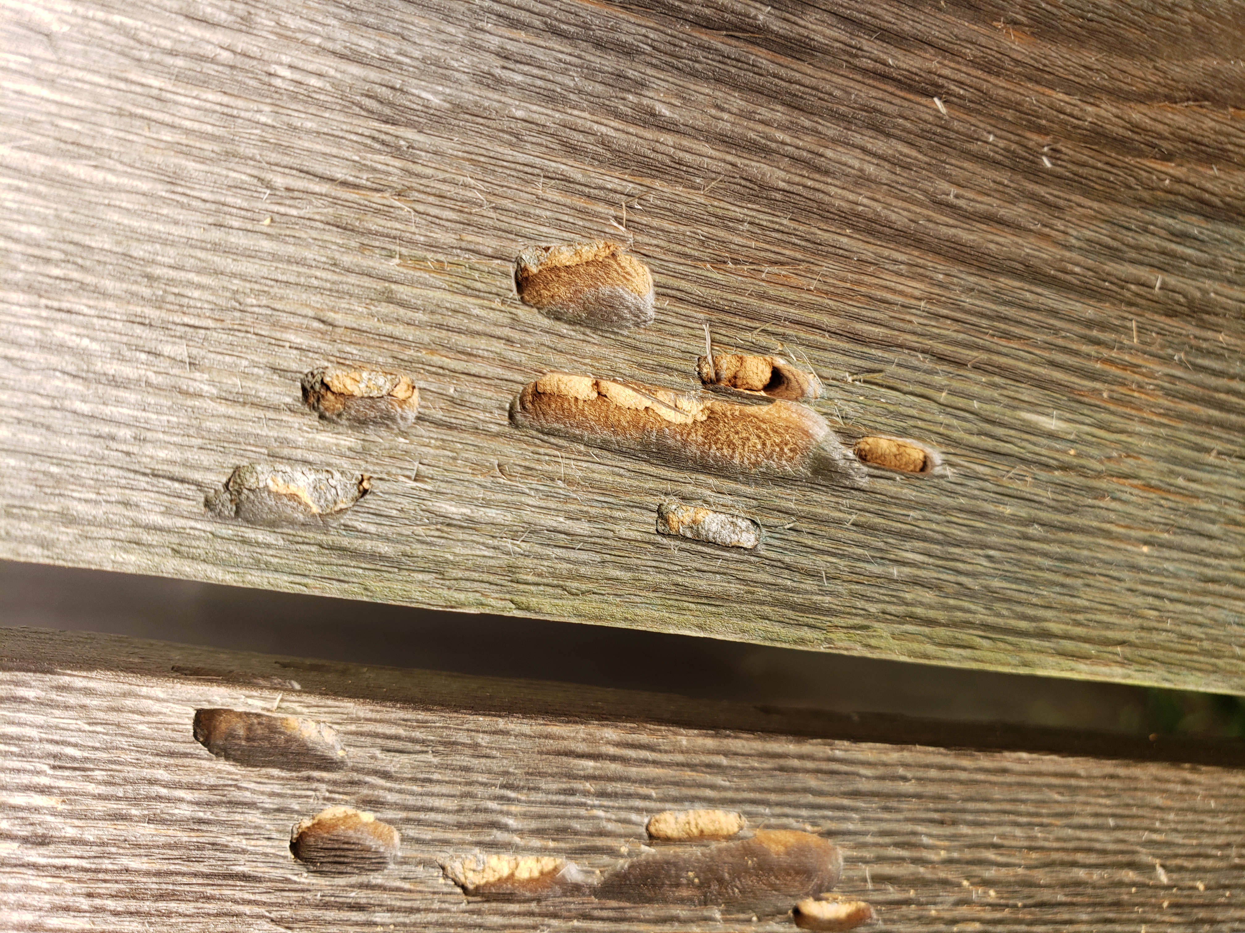

Get you another estimate from a reputable company! That Is Not Termites!

Wow. Ok I'm a little flummoxed now. What is causing that?

Also I forgot to mention, the fence is cedar.
Psalm 91:2

I think that is some type of worm. We just found some in a few boards we had to replace.
When we were cutting up the pickets to get rid of, there were some still in the boards, dried up dead.

I'm more carpenter than exterminator.
Termites will build a tunnel to cover themselves, and you usually see damage starting at the ground and moving up. That looks like borer beetle larva damage to me. The beetle lays eggs in the tree while it is alive and the larve eats the wood as it grows and develops. Do a search for cedar borer beetle and see if it matches up.
