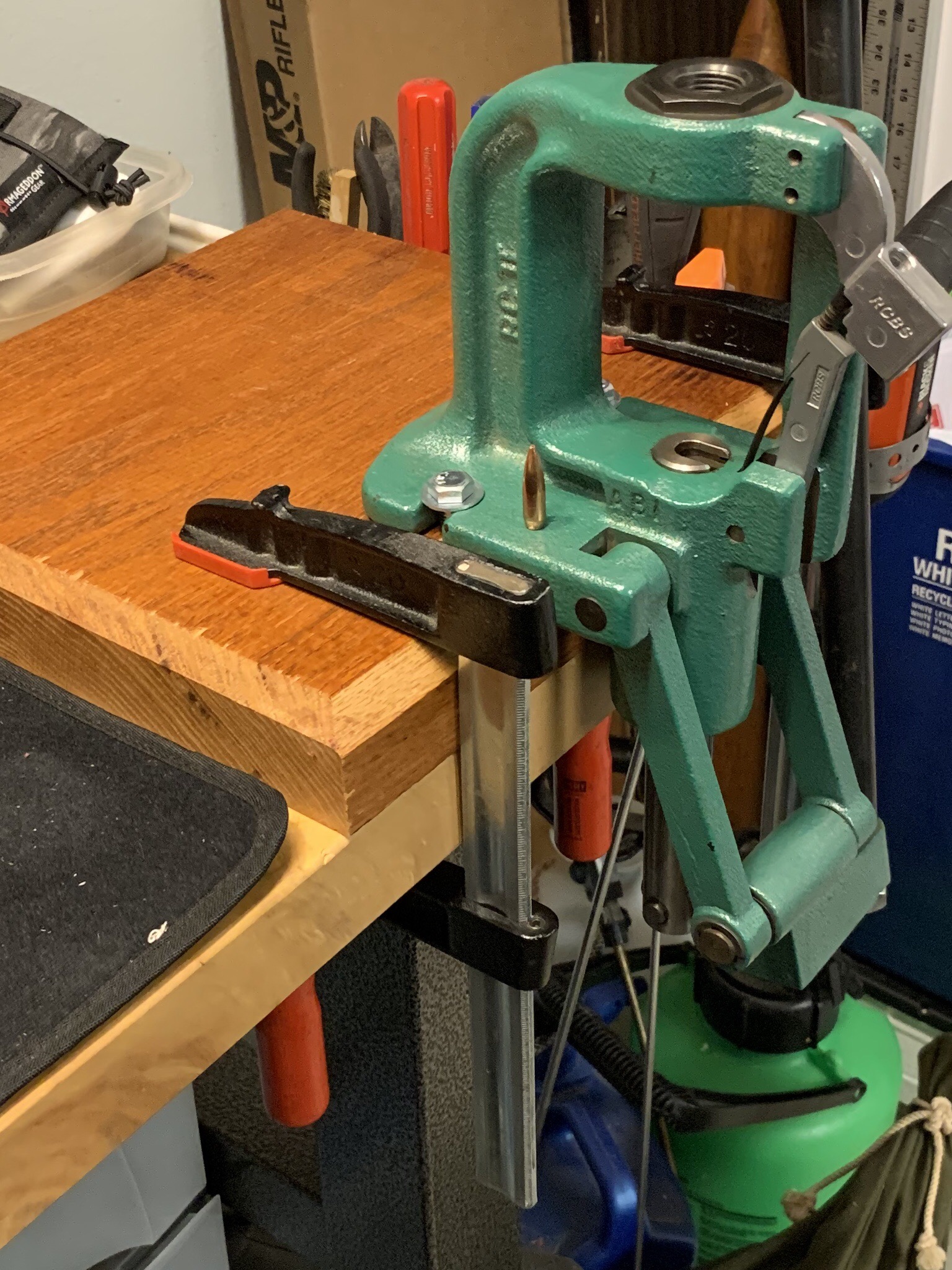

I have limited space too, so I bolted the press to a thick piece of oak, them clamp to the table. It is solid. Can always unclamped and store it. Also, LE Wilson case gauges are great for rifle, I use Hornandy case gauges for pistol. I like Lee dies, although I have other brands too.

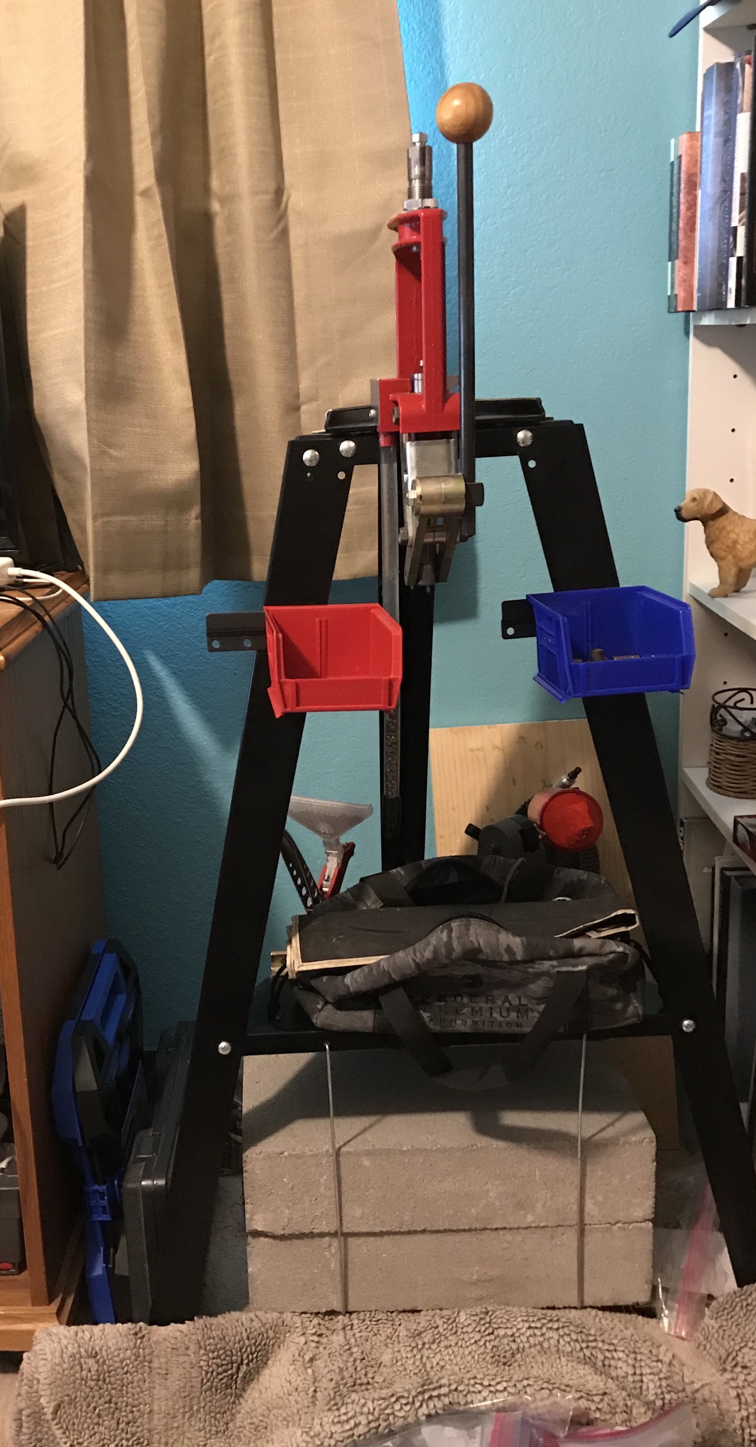

I setup in my home office with limited room. Use an old computer desk as my flat surface and a Lee stand for the work. It’s nestled between bookshelves and the desk.
