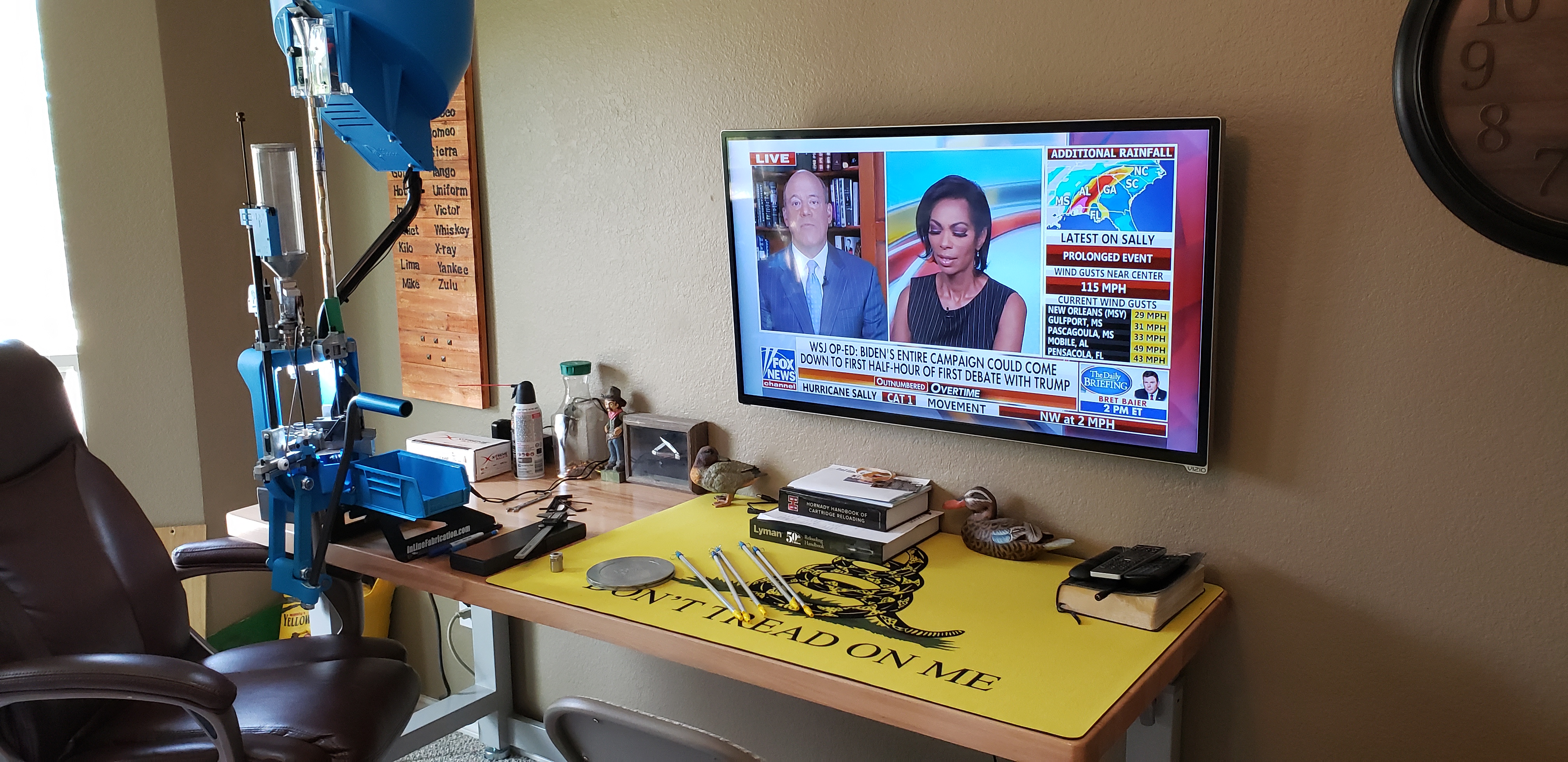

Initial Plan:
Deprime/sizing in stage 1 then wet wash in the cleaner. After deprime/final wash and dry run the case back through stage 1 again just and then onto priming...... If brass is cleanish already and blown out from any noticable debris is a prewash before deprime recommended? Thoughts?
Forward looking prep: In my small uneducated mind it seems a bit overkill/redundant to use stage 1 for this step and I assume would result in added wear on the die. Anyone using the Lee App for this step? Or what about a universal deprimer on a single stage? Either seems to be a better solution for depriming before wash and are reasonably cheap solutions.... Am I overthinking this part?
