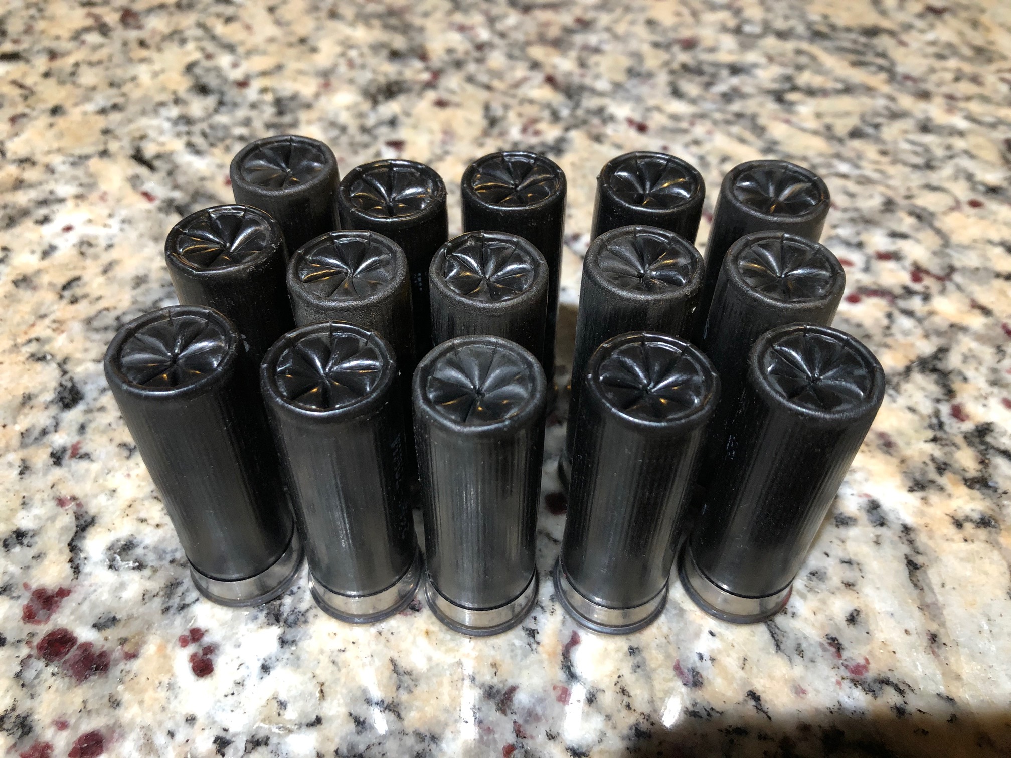

Loaded some shells, these are my second batch. My first batch was not as good looking due to a loose adjustment on the final crimp station on my shell press. Considering I'm still new to reloading, I'm pleased with the results.

Looking good!
