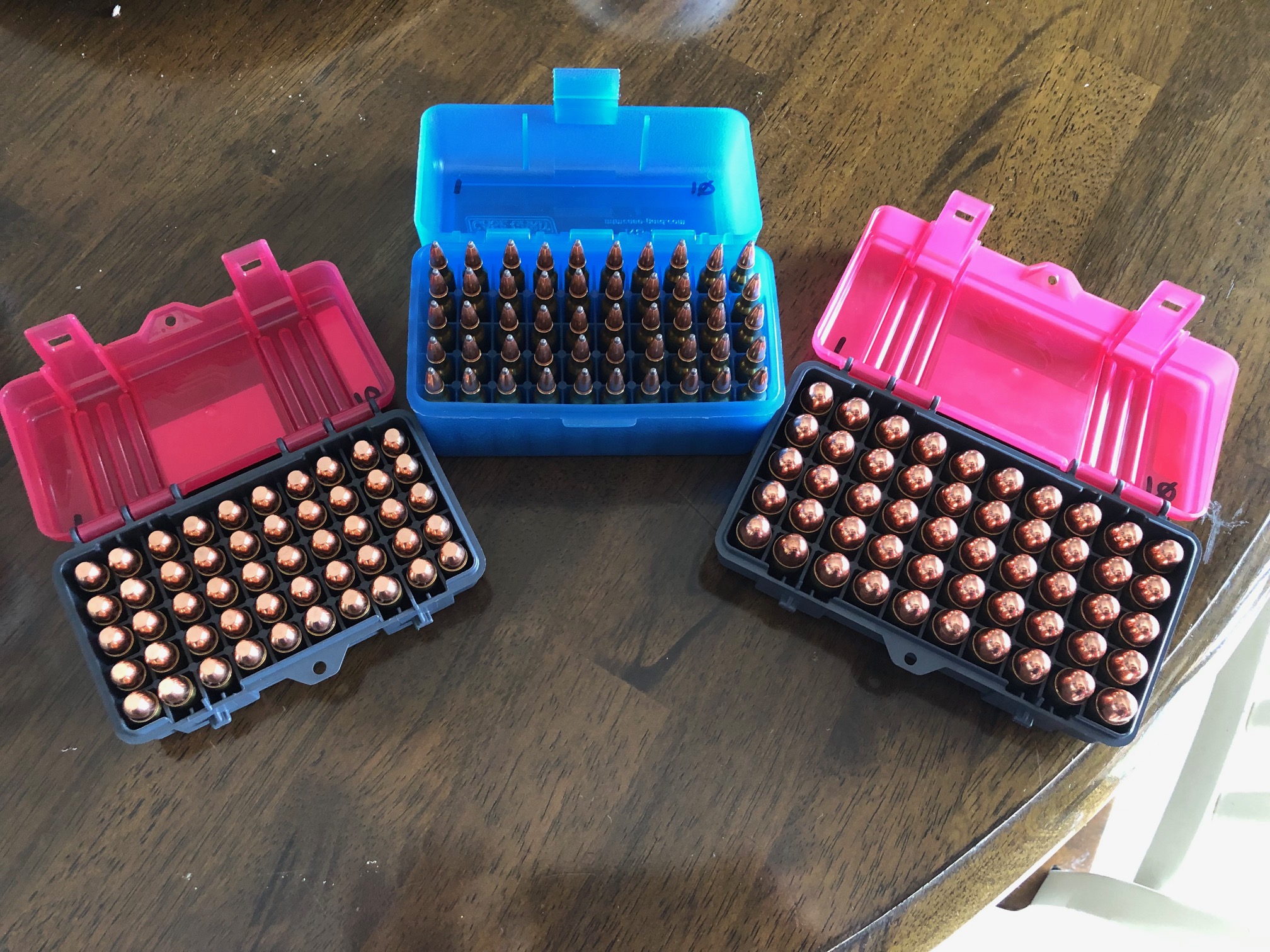

Having finally sourced the remaining materials needed (primers mostly), I set up all of my seating dies and loaded my first ever batch of ammunition :hurry:
Did 50 each of 9mm, .45, and .223. Since I'm still learning and new at this, in each set of 50 I decided to work up the charge weights. So I have 5 of each powder weight, working my way up to max charge or near max charge. I felt this was more important on the handgun rounds as I am using plated bullets. I plan on using a chronograph on my next range visit so I can log the results and find a good balance of powder charge/velocity/accuracy/safe loads.
