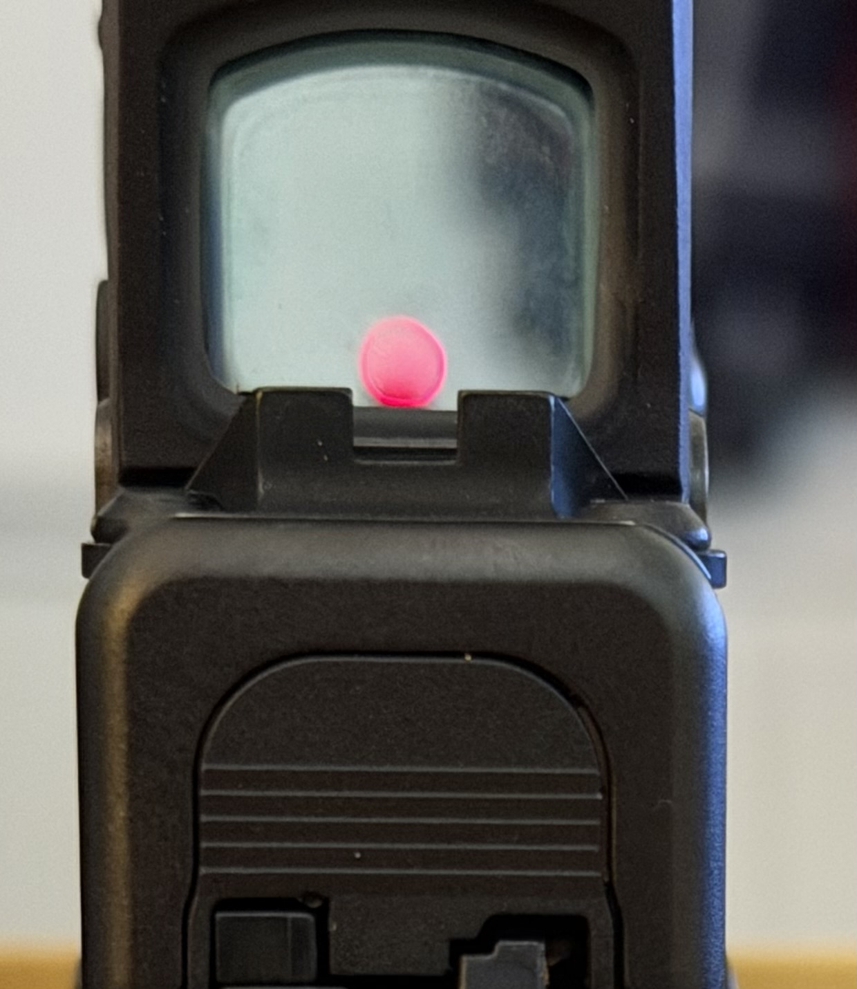

In the picture below, you can see how very low the rear sight notch sits relative to the bottom edge of the glass.
As you can see, the rear sight is an integral part of the wedge system. You can’t just swap it out for a taller sight, unless the new sight has the correct shape and can take mounting screws.
There were two reasons I went with this optic/pistol combination rather than others. (1) I wanted to stay with Glock, but I also wanted to have a 100% ambidextrous pistol; and (2) I watched torture tests done by Kentucky Ballistics and others where it was subjected to unbelievable amounts of abuse up to and including sledgehammers and run over by a truck…TWICE…and it never even lost zero, let alone came loose. But I didn’t realize the iron sights would be a problem.

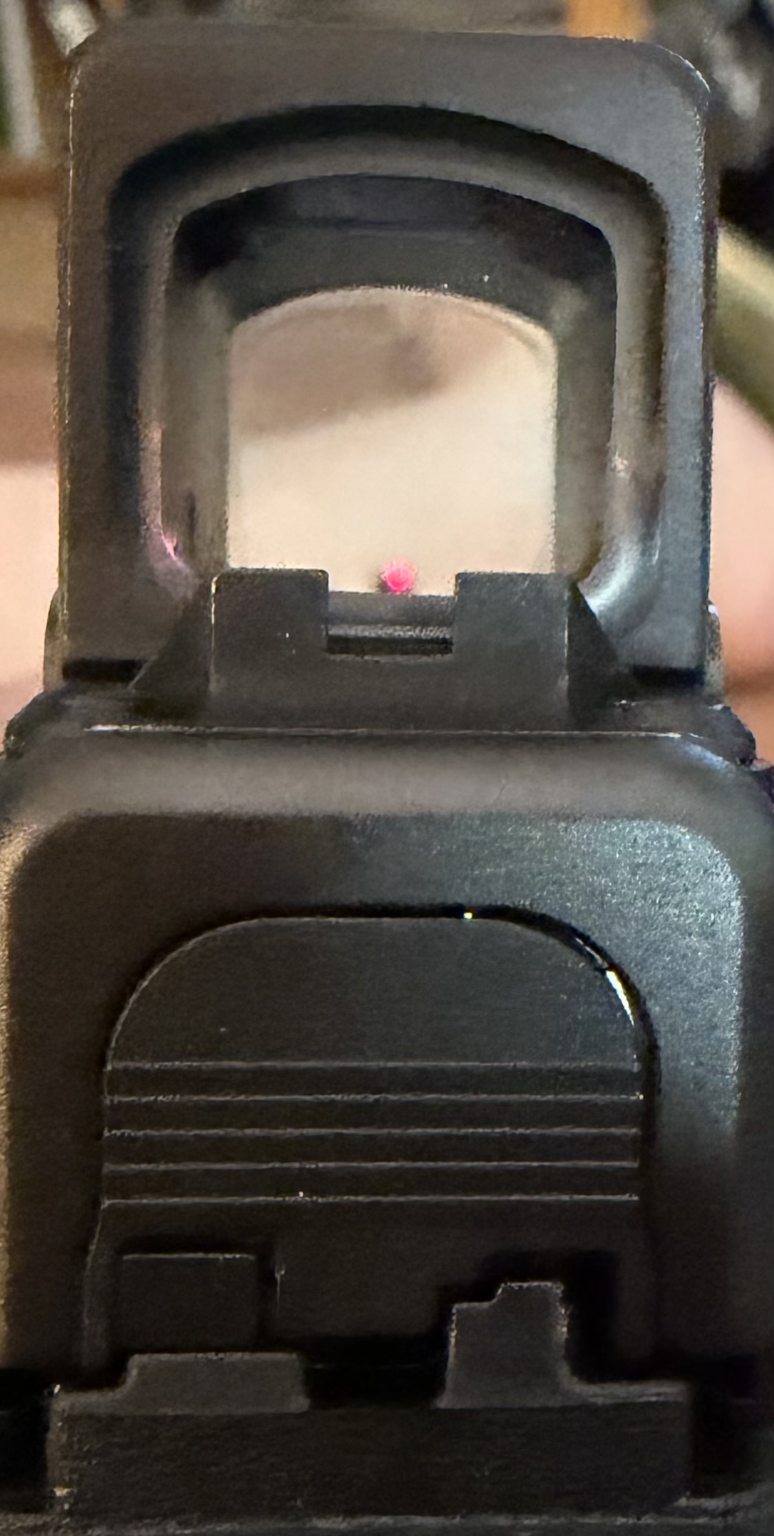

I tried to take a picture of what you see in the optic. With the iron sights lined up, the dot sits right on top of the front sight, but the dot is smaller than it looks in this picture. As you can see, it’s all right at the bottom of the glass, and it’s hard to pickup. Also the glass only becomes visible in the upper third or so of the rear sight notch.
