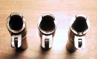

This was a fairly common problem with older 1911's which were designed to feed FMJ ammo only, but has largely gone away with the manufacturing specs currently in use. If you're shooting an older gun (say 1970's vintage) this could well be the problem.pbwalker wrote:I don't know any other way to describe it other than the bullet is being pushed down into the brass in my 1911. This isn't from repeated chamberings, but usually 1 or two. The bullet itself is pushed down. I've been removing these rounds as I am unsure if they are safe or not.
Any reason why this would occur?
A quick check to see if this might be the case is to compare the chamber opening of your barrel with a recently manufactured one from Kimber, Springfield, etc. If the opening in your barrel looks narrower and more restricted than the other one, this would probably be a good place to start. The fix is either a new throated barrel, ramp / barrel throating and polishing by a qualified gunsmith, or some combination of both.

See attached picture...Left to Right...Mil-spec, throated, and dimpled. Usually, a throated or dimpled will feed JHPs. My Colt 1991 has a dimpled and feeds them.Excaliber wrote:This was a fairly common problem with older 1911's which were designed to feed FMJ ammo only, but has largely gone away with the manufacturing specs currently in use. If you're shooting an older gun (say 1970's vintage) this could well be the problem.
