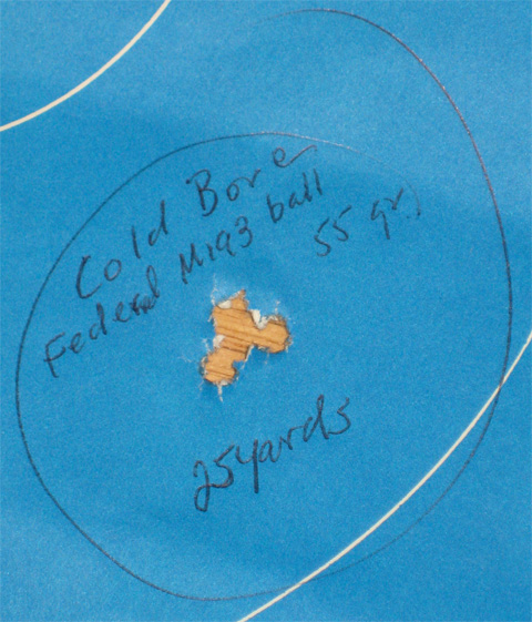

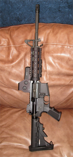

My son bought a 16" HBAR upper by Model 1 from a vendor selling all kinds of lowers and uppers. IIRC, he paid about $540.00 for it. He already has all the other stuff for a really nice carbine, but the DPMS lowpro 16" bull-barreled upper he already had was a bit too heavy to be handy (and he already has a 24" bull-barreled RRA varminter). If you like a carry handle, but want options for optics, buy an upper with a removable carry handle (or buy yourself a flat top upper and a separate carry handle).
FWIW, my carbine, with an ER Shaw 16" light M4 barrel on it, can shoot 4 cold bore rounds that touch each other at 25 yards, with an Eotech sight (see attached photo). How accurate do you need to be with a carbine (see attached photo)? Admittedly, the groups opened up a bit as the barrel heated up, but after 60 rounds, I still put another 20 rounds into a golf ball-sized hole in the head of a B-27 target - and I am strictly an average shot.
Granted, a free-floated handguard will improve your accuracy somewhat, but from a strictly practical perspective, the $69 UTG forend on my rifle didn't seem to hurt any. What it all means is that I have a fair chance of hitting a man-sized target pretty confidently out well past 100 yards, without a magnifying scope. For me, the bottom line is that you have to define what it is you are building this rifle for. Me, I opted to own two ARs, one very accurate gun with a long heavy barrel and a good scope, and all the other good stuff like a free floated handguard, 2 stage trigger, etc.; and the other a handy carbine which would be quick and easy to use. The first is heavy and doesn't lend itself well to home defense or plinking. The second is less usable for hunting, but better for defense and plinking.
It was probably more money to do it that way, but I also had to make fewer compromises, and I got exactly the rifles I wanted for the applications intended - one for target shooting/hunting, and one for home defense/plinking.
