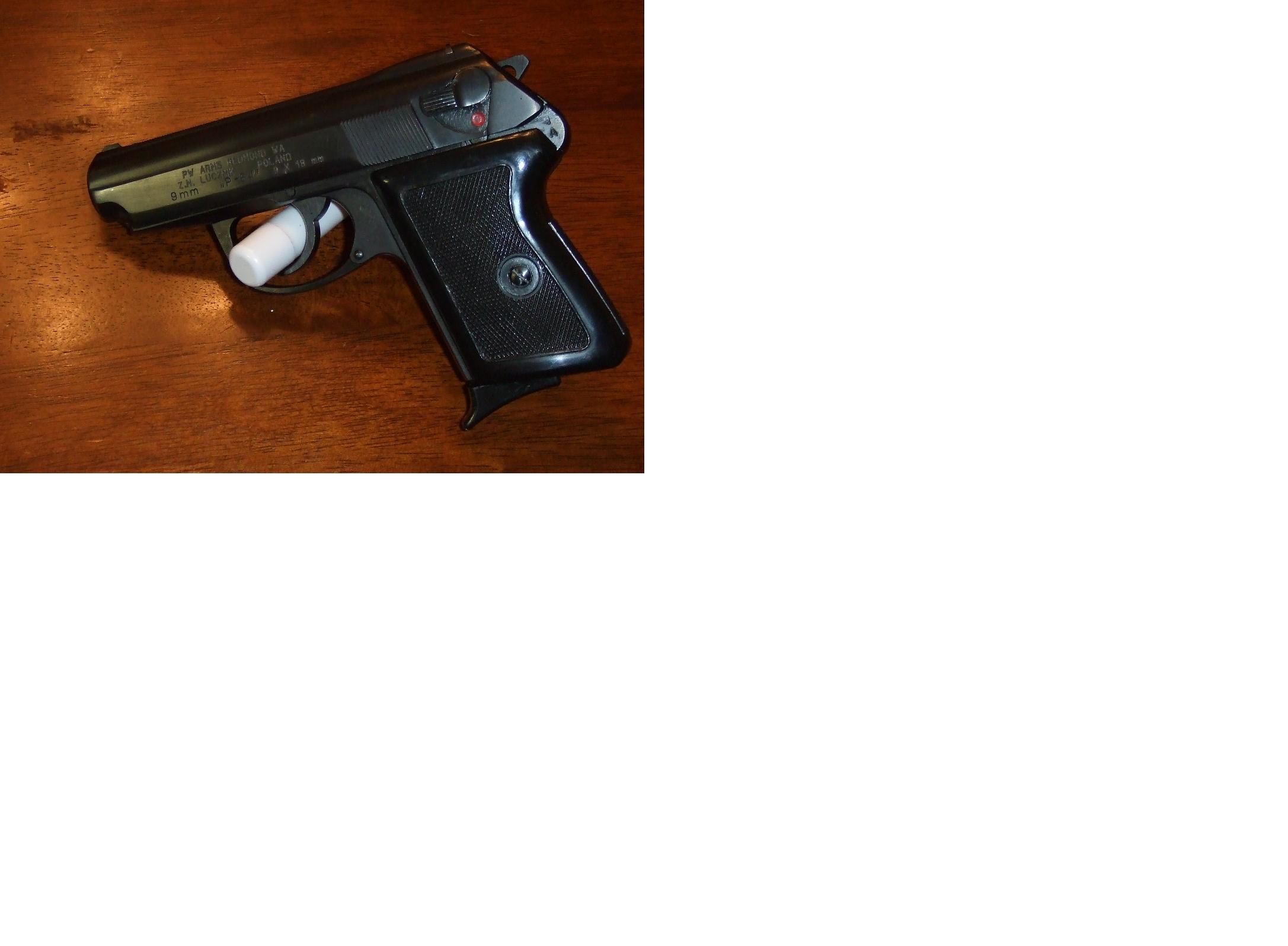

Well I went and picked her up today! Very happy with how she looks, much better then any I have seen at the gun shows, I think it will clean up very nice!
1977 production, matching serial numbers on the mag and weapon. Does anyone have anything to say about using WD40 and brake cleaner to clean all the Cosmolean off?

You can use WD-40, but be SURE you get all the WD40 residue off as it will sort of "carmelize" and gum up the works. The best stuff I've found for cosmoline is Mineral Spirits. Detail strip the pistol (see http://www.p64resource.com" onclick="window.open(this.href);return false; for information) and put all the parts in a tub of Mineral Spirits. Swish around and scrub with a toothbrush. Reassemble and re-lube. IMO, using this method is the safest way to get cosmoline off.
