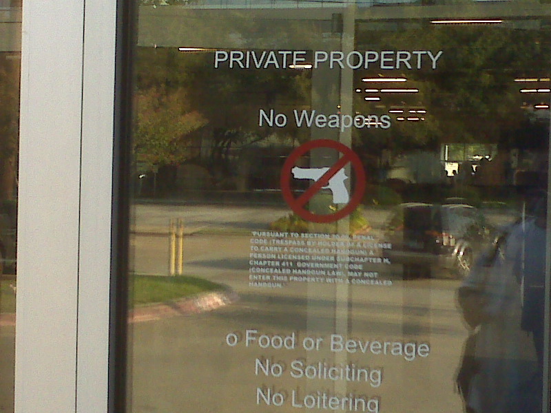

I'm confused by a sign. The Sportsplex @ Valley View in Dallas is a sports facility that has basketball, baseball, volleyball & other sports inside. The 30.06 sign looks wrong. The letters aren't big enough & other things missing per the Tx/DPS law. It looks like it might be an old sign. However, it has "Private Property" above the sign. This looks like it might fall under being informed by the owner rule. Do I carry or not? I didnt because after looking the CHL laws, this sign seemed to create a gray area & i didnt want to risk it.

It is not an enforceable sign, you are correct. it does not meet all of the criteria.
I cannot measure the size of font from here, but I can say it does not have it in English and Spanish.

As said, It's clearly not large enough, and is missing the Spanish required language.
It IS the proper English wording though, not the old one.

I thought that the sign was wrong / old version due to letter size (not 1/2" lettering). However, does it meet the criteria of being notified by the owners of the property & thus we cannot carry on the property?

Negative, it does not meet the definition of 'notice' as defined by TPC Section 30.06!arsonist4him wrote:I thought that the sign was wrong / old version due to letter size (not 1/2" lettering). However, does it meet the criteria of being notified by the owners of the property & thus we cannot carry on the property?
Therefore Carry is not illegal at this location.
The lettering has to be a full 1" Tall, not 1/2". If the lettering is not 1" Tall or taller, it doesn't count.
Carry away!

Why make it harder than it needs to be?Sec. 30.06. TRESPASS BY HOLDER OF LICENSE TO CARRY CONCEALED HANDGUN. (a) A license holder commits an offense if the license holder:
(1) carries a handgun under the authority of Subchapter H, Chapter 411, Government Code, on property of another without effective consent; and
(2) received notice that:
(A) entry on the property by a license holder with a concealed handgun was forbidden; or
(B) remaining on the property with a concealed handgun was forbidden and failed to depart.
(b) For purposes of this section, a person receives notice if the owner of the property or someone with apparent authority to act for the owner provides notice to the person by oral or written communication.
(c) In this section:
(1) "Entry" has the meaning assigned by Section 30.05(b).
(2) "License holder" has the meaning assigned by Section 46.035(f).
(3) "Written communication" means:
(A) a card or other document on which is written language identical to the following: "Pursuant to Section 30.06, Penal Code (trespass by holder of license to carry a concealed handgun), a person licensed under Subchapter H, Chapter 411, Government Code (concealed handgun law), may not enter this property with a concealed handgun"; or
(B) a sign posted on the property that:
(i) includes the language described by Paragraph (A) in both English and Spanish;
(ii) appears in contrasting colors with block letters at least one inch in height; and
(iii) is displayed in a conspicuous manner clearly visible to the public.
(d) An offense under this section is a Class A misdemeanor.
(e) It is an exception to the application of this section that the property on which the license holder carries a handgun is owned or leased by a governmental entity and is not a premises or other place on which the license holder is prohibited from carrying the handgun under Section 46.03 or 46.035.

You sure about that? I don't recall anything in my CHL class pertaining to 30.06 and "Subchapter M, Chapter 4## Government Code"dicion wrote:It IS the proper English wording though, not the old one.
Looks to me like it IS the old sign...

It says "Subchapter H, Chapter 411, Government Code" which is the correct reference on a current 30.06 sign.pbwalker wrote:You sure about that? I don't recall anything in my CHL class pertaining to 30.06 and "Subchapter M, Chapter 4## Government Code"dicion wrote:It IS the proper English wording though, not the old one.
http://www.txdps.state.tx.us/administra ... osting.htm" onclick="window.open(this.href);return false;
The old Sign would reference Revised Vernon's Statutes.

Ahh, I stand corrected. I didn't see the .30-06 and thought the 4### was the dreaded 4413 (or whatever it was).dicion wrote:It says "Subchapter H, Chapter 411, Government Code" which is the correct reference on a current 30.06 sign.pbwalker wrote:You sure about that? I don't recall anything in my CHL class pertaining to 30.06 and "Subchapter M, Chapter 4## Government Code"dicion wrote:It IS the proper English wording though, not the old one.
You've got some good eyes! I was staring at the screen like this:

The sign is enforceable.
It very clearly states no food or drink, loitering, or soliciting.
