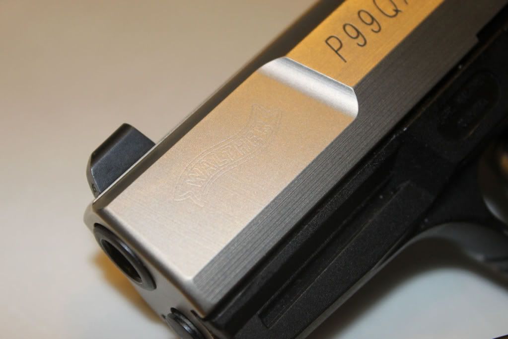

Hi folks, thought I'd post these pics of my newly refinished P99 slide and one magazine. Done at CCR with their ceraplate process, total cost $99 for slide+mag, included return postage. The slide had alot of holster wear and looked pretty shabby, so I thought I'd give it a pre-Christmas treat :-)

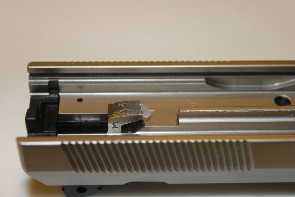

The slide color is very similar to stainless, marginally duller, with a very slight - almost imperceptable - goldish hue. The brushed texture is actually the underlying surface texture of the slide itself. The finish feels slightly lower 'drag' than before, although not 'slippery'. It looks great and there is not a single defect on the plating whatsoever - they did an excellent job with the surface prep and plating, and even replaced the red paint under the end of the extractor that serves as the loaded chamber indicator.

It's an electroless nickel with boron nitride; a true plating as opposed to a cured coating. I believe it is similar to the Robar NP3 process, except that one has teflon suspended within the plating rather than boron nitride.
