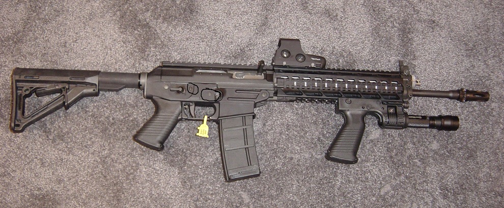

Ok, take these two pins out (see attached pic)... oh, note that this is NOT my rifle..., then when you pull out the trigger assembly, pay close attention to where everything goes, and when you pull it out, try not to let anything fly away. It shouldn't but just be on the safe side... Also, I couldn't find any exploded views of that rifle online, so I'd say if you're not comfortable with triggers, ya might want to just bring it to a gunsmith and watch him do it a few times so you get the hang of it.
I guess I should mention that you definitely need to separate the upper and lower receivers to do this-- you'll be pulling the trigger out the top of the weapon.
Lastly, it's been awhile, but if I remember correctly, the pins have notches in them. You'll want to install them with the notches aligned as you found them... Here's an example from an AR-15:
http://www.google.com/imgres?imgurl=htt ... 9,r:16,s:0
Anywho, best of luck to ya. There's not too terribly much I could find online for pulling that bit out. Granted, I only spent about 2 minutes searching, so perhaps a more thorough search will turn up an exploded view or a decent video...
