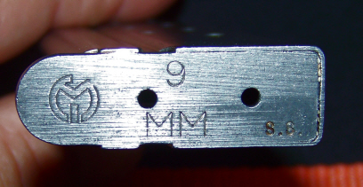

I had a lady in the class I taught yesterday that had the prettiest pink gripped and pink lettering STI Elecktra in 9mm. Caught my attention first because it really was a good looking weapon. Then it got my attention because it could run very well till the last two rounds in the mag. Constant fail to feed. Seemed dry so I lubed it, no help. Got her to tighten grip, helped some but not enough. I finally went and got her a mag from my bag, a Kimber mag I use in my PT1911 9mm. It was longer of course but it functioned fine. After checking her mag which was a MecG, you could feel a rough spot as you were puching the follower down. It was a real piece of junk. Too bad nobody at STI checked that before they sent it out. I guess maybe they fired a one round check or maybe they never tested it with that particular mag.
I felt bad for her, well, mainly for her husband. He bought her that to use in the class and all he could afford afterwards for himself was a HIghPoint . It was a shame the Elecktra couldn't function as well as a "right out of the box" HighPoint. He shot a 250 with it too. Go figure. :headscratch
Actually I am not sure what brand that mag was. I do know I bought two just like it for my PT1911 and only one of them works. I'll see if I can dig up the pic, but I am suprised STI is using that junk. :eek6
I found the pic. edited to add it.

That's a Metalform mag. Metalform used to supply 1911 mags to the U.S. military they are usually good. I have a few .45 mags made by them no problems.

For $1300, it really should have a decent magazine.
1911 forum had a few refs to bad mags in the Elektra 9mm:
We took it out with a Kimber mag & it ran flawless! I called STI & they said to send the mag back to them & they'll replace it. He also told me to try Tripp mags in it.
I'd get a short Kimber mag for it (If they can find one) and send the POS back to STI.
I'm not familiar with Tripp mags.

MoJo wrote:Tripp mags are what you finally buy when Wilson mags won't make your gun run. Tripp rocks!
I don't think I have tried any Tripp mags. My Wilsons all work fine, however I will have to say Metal Form fails on the 9mm mags. I have two and seing the third one yesterday in the Elecktra, and only one out of three work kind of makes me think their success rate is low. I also have some Mecs that work really well.

Chemist45 wrote:For $1300, it really should have a decent magazine.
I CAN believe it if they are sending them out with the Metal Forms. They even feel like junk , heck the floor plates are spot welded on.
