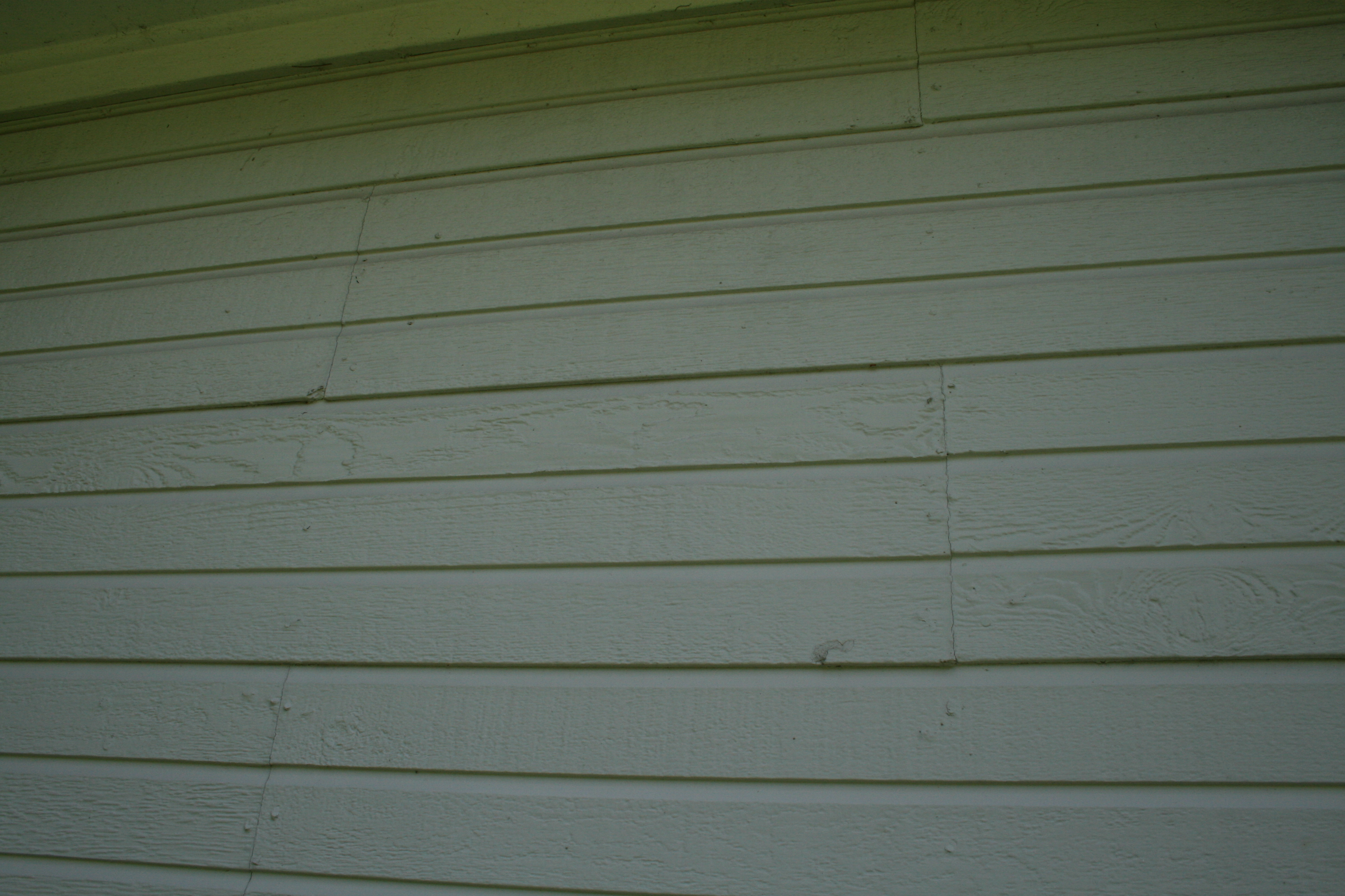

Our garage has brick on the front, but two sides and the back are some kind of siding. The sprinkler system has damaged the lower portion of some of it and I need to replace it. Unfortunately, I have no idea what it is. It looks like 3 1/2" planks, but it's not.

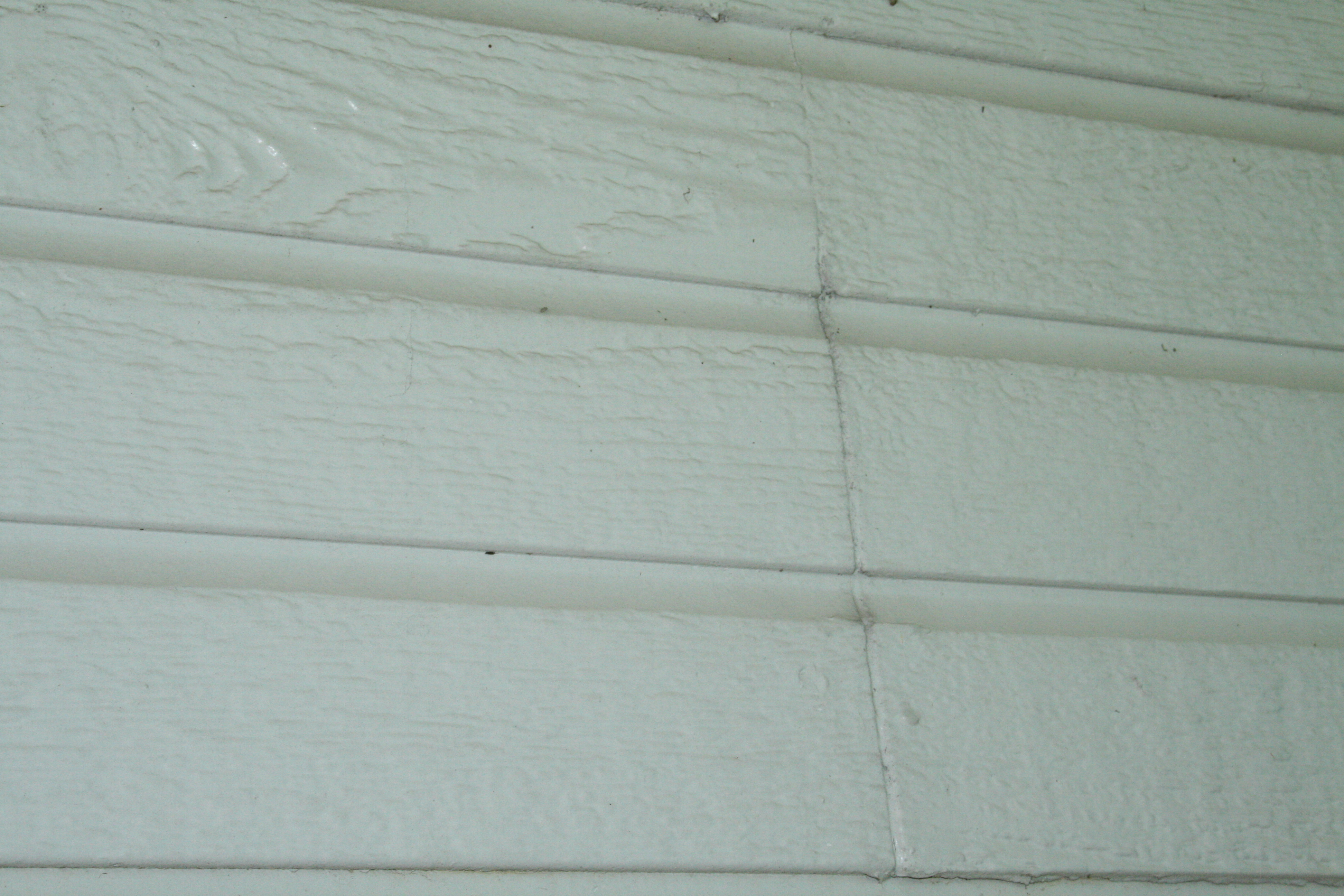

Each section is 11" tall with what appears to be thee 3 1/2" "planks." It also isn't wood; it's some type of fiber. If I was going to replace everything, I'd use Hardi Plank, but only a small portion is damaged. Photos are below. Does anyone know what this is?
Thanks,
Chas.
Thanks,
Chas.

I have known this as a 'press-board siding' that is basically a paper/wood composite that is manufactured with a wood 'grain' to look like real wood. You can also find it called 'Masonite' but there are varieties out there that have a cement added in the mix....sort of like the 'hardy-shake' shingles.

It could be MFD or multi density fiber board which is standard contractor grade material. It needs to be cut with a fine tooth saw blade 60 to 80 tooth and edges sealed or hung so edges dont sit in moisture.

It is definitely a wood-textured fiber composite siding. Looking at the style, it appears to be Dutch Lap Triple 3" (or triple 3 1/2"), but not sure of the brand. I see lots of triple 4", but I will keep digging. I will also check with my Father-In-Law and see if he knows a company that makes that; he has been in the building business for almost 60 years.

On further review, take another look and make sure it is three on one sheet. The Certainteed Dutchlap Double 4 has a 7" exposure, which would look like 2-3.5" boards.

I checked and it's three on a sheet. I'm worried because I can't find anything using "Dutch Lap Triple 3."Keith B wrote:On further review, take another look and make sure it is three on one sheet. The Certainteed Dutchlap Double 4 has a 7" exposure, which would look like 2-3.5" boards.

I don't find any manufacturer that lists anything with those dimensions. I will keep looking. Not sure how old your home is, but maybe the builder do the home, maybe they have info on what brand it is. The other option is depending on the damage, you might be able to form Bondo into the place and 'mold' it into the proper shape and texture.

Charles, my best guess, it's an older product version from the linked manufacturer. I would start with one of the larger lumber yard chains in the Houston area and ask for their help.

Our home is 19 years old and it doesn't look good for finding the exact siding. I really don't want to replace all of the siding since only about 100 linear feet is bad.

If just the bottom is damaged you might consider removing damaged course and rip cutting the damage section and get a custom mill to make a single replacement plank of rough cedar or similar grained lumber. There may be another product like Hardi or Certainteed that have a molded grain you could cut to fit also. A good carpenter may be able to rip cut the damaged section in place and replace a single plank. Since the siding is installed bottom course first you're going to have to pry the second course up to remove and replace the entire bottom course if you do find the original stock. Good luck.

I think there's a Hardiplank size that will work for precisely what you suggest.puma guy wrote:If just the bottom is damaged you might consider removing damaged course and rip cutting the damage section and get a custom mill to make a single replacement plank of rough cedar or similar grained lumber. There may be another product like Hardi or Certainteed that have a molded grain you could cut to fit also. A good carpenter may be able to rip cut the damaged section in place and replace a single plank. Since the siding is installed bottom course first you're going to have to pry the second course up to remove and replace the entire bottom course if you do find the original stock. Good luck.

Chas...if you can pop the nails/fasteners on a piece enough to look at the back of it...there will be markings (required) that will tell you who the manufacturer was/is and probably the designated "style".
From there...its a simple matter of using your Google-Fu to locate some (if still available).
Be sure and get accurate measurements, 11" siding would be an odd size (12" being more common) and that type of siding is called "triple lap".

Good thought Flint. I am almost gonna take a bet on it being Certanteed. I built a house back in 1990 and used a heavy pro-grade vinyl on part of it and it was a 3" lap. Certainteed was the only company that made that it in that small a width; all of the others were a 4".

I'll pull a section tomorrow. I suspect it is 12" overall with less exposed, but I'll know for sure tomorrow.flintknapper wrote:Charles L. Cotton wrote:Our home is 19 years old and it doesn't look good for finding the exact siding. I really don't want to replace all of the siding since only about 100 linear feet is bad.
