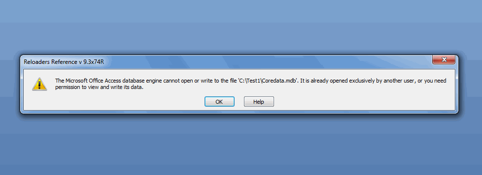

This is what I get either way, friend

Re: SourceForge Free Reloading Program
Try uninstalling and reinstalling the program. Make sure you use the 'Do not have Microsoft Access' option. If that still doesn't work, try loading the Open Office Base application (free) and see if you can then install it telling the program you have Access.
Also, what version of Windows are you running? That may be an issue.
