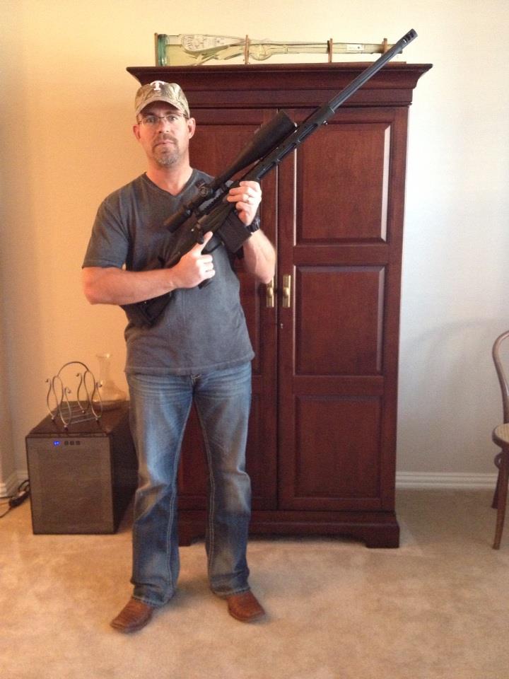

Here she is:
6.5 Creedmoor
Stiller Tac 30 Predator Action
XLR Evolution Chassis
Brux Barrel
Jewell Trigger
NightForce 12-42x56 Scope
Harris Bipod and Pod Lock are on the way.

Are you sure that rifle is legal? It looks evil.

It's a green rifle, not a black one, so it's OK.baldeagle wrote:Are you sure that rifle is legal? It looks evil.

I have that exact same rifle and scope..... the Hijos de Villa and Nightforce

Nice boots!
And rifle too.

I have the pistol, too! I almost got the bullet bottle last trip south of the border.

That rifle is a hot mess. ESP the scope.

Great looking rifle! You will like the Creedmoor, it is a very accurate cartridge and is easy to load if you go that path. I have a Savage Long Range Precision in that caliber and it is extremely accurate out to 1000 yards (and probably further but that is as far as the range goes where I can shoot it).
Do you plan to load for it or shoot the Hornady factory ammo? Their ammo is good (1/2 MOA or maybe a little better). If you decide to reload, Reloader 17 is a great powder (at least in my rifle) and will give you a little more velocity than the H4350. I have been using the Lee neck sizing dies with great success. That is now a catalog item for them as the set I got was the first ones they built (they made them custom). Those dies work extremely well and make some very accurate ammo.
Please let us know how it shoots.
