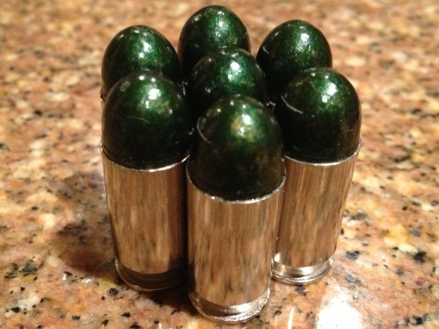

Kept reading great reviews about Donnie's Bayou Bullets and the unique lube/coating and bought some sample packs from him. Started with my favorite mid-range load for .45 LRN bullets with 3.8 gr of Clays, Fed Match Primer, and used nickle plated cases (thought that'd look nice against the dark green...). They passed plunk and cycling tests and will be headed for the range this weekend with my 1911.

You'll be in good shape if they shoot as good as they look.

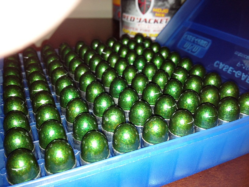

I'm still loving my Bayou Bullets...just need to order more, and a variety

Tried out the first 7 and my 1911 sure seems to like them. No noticeable leading. Bit of a funky smell with Clays powder, not heavy and barely discernable, but smelled a bit like burned circuit board... I'm trying out the SWCs next and placing an order. Definitely like them!

Those are just downright purty!mjoplin wrote:Tried out the first 7 and my 1911 sure seems to like them. No noticeable leading. Bit of a funky smell with Clays powder, not heavy and barely discernable, but smelled a bit like burned circuit board... I'm trying out the SWCs next and placing an order. Definitely like them!

How was the smoke and was there any residue from the lube/coating in the barrel? I tried another type of bullet with a hard coating and it left no lead in the barrel, but it was virtually impossible to get the lube residue out of the barrel.mjoplin wrote:Tried out the first 7 and my 1911 sure seems to like them. No noticeable leading. Bit of a funky smell with Clays powder, not heavy and barely discernable, but smelled a bit like burned circuit board... I'm trying out the SWCs next and placing an order. Definitely like them!

since first posting about Bayou Bullets a couple of month ago, I've shot a few hundred of them in .45 acp and .38 spl, and have never changed my delight with them since firing the first few test rounds. I use a lot of Unique powder with cast bullets, and had assumed that most of the "smoke" was due to the often chided Unique. My opinion was apparantly misguided ... the Bayou Bullets result in minimal smoke. As to lube residue, I have never seen any evidence of any in my barrels, but I don't push my cast bullets to max velocities.

In shooting the first 7 I don't have much of a statistical sampling, but the barrel was squeaky clean and devoid of lube or lead. Started with a clean gun, shot around 30 or so rounds of 230 FMJ and then finished with the 7 Bayou bullets. Will shoot some higher quantities this weekend, but am very happy with them. No smoke, no residue.
