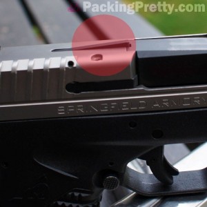

I'm sorry.... I didn't mean that as a poke at you. It's just that the Loaded Chamber Indicator is one of the prominent safety features that makes the XD/XDM/XDS guns so attractive. Between that, the Striker Status Indicator (XD/XDM only), the grip safety, and the trigger safety, I am very impressed with the attention to safety detail in these guns. I just assumed that you were aware of the feature too, if you have one of these guns.Blindref757 wrote:Maybe because I'm pretty new to shooting (relatively speaking) and don't have a lot of experience with guns!The Annoyed Man wrote:Why would you do that? If the breech is closed and there is a round in the chamber, the Loaded Chamber Indicator would be prominently and obviously raised just aft of the ejection port on the top of the slide. No need to do a "press check" to visually verify.Blindref757 wrote:The more I sit here and think about it, I think maybe that when I dropped the mag out, I may have pulled the slide back slightly to check and see if the round was there.
Here's a picture of it. As you can see, you wouldn't need to do a press check to confirm a loaded chamber. It's actually designed for tactile confirmation. I suppose it is possible that it could get stuck in the up position on any empty chamber, but there is no way it can get stuck in the down position on a loaded chamber, so it is a reliable safety indicator.
