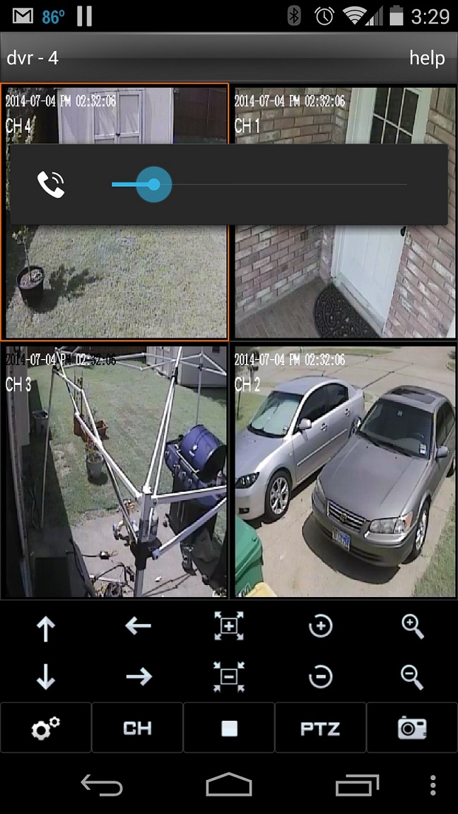

I purchased this system:
http://www.amazon.com/Zmodo-Surveillanc ... ir+cameras" onclick="window.open(this.href);return false;
With a generic 500Gb HD installed in it.
Ran ethernet cables through my attic and terminated them with these to convert the ethernet to power and Video: http://www.amazon.com/LTS-LTA1010-Passi ... ity+camera" onclick="window.open(this.href);return false;
The system is very generic. Kind of low quality. But apart from my labor the whole setup was only about $250-$300.
Here is a night time video of the front driveway. As you can see its grainy, but I think you could get a general description of a suspect. Or at least a time frame of when something happened.
https://www.youtube.com/watch?v=TQocVmtIyZA" onclick="window.open(this.href);return false;
I also was able to set it up to be visible from my phone whether I'm at home or not.
I can post more detailed installation pictures. Because this system is such a cheap Chinese system it took a lot of fine tuning, and ductape/gun/McGuyver-ism to make it work the way I wanted it to. But if you are good with computers you can figure out of baffling DVR software and if you are good with handyman work (unlike who did a crap crap job drilling holes and running cables) you will be able to make it all work.
