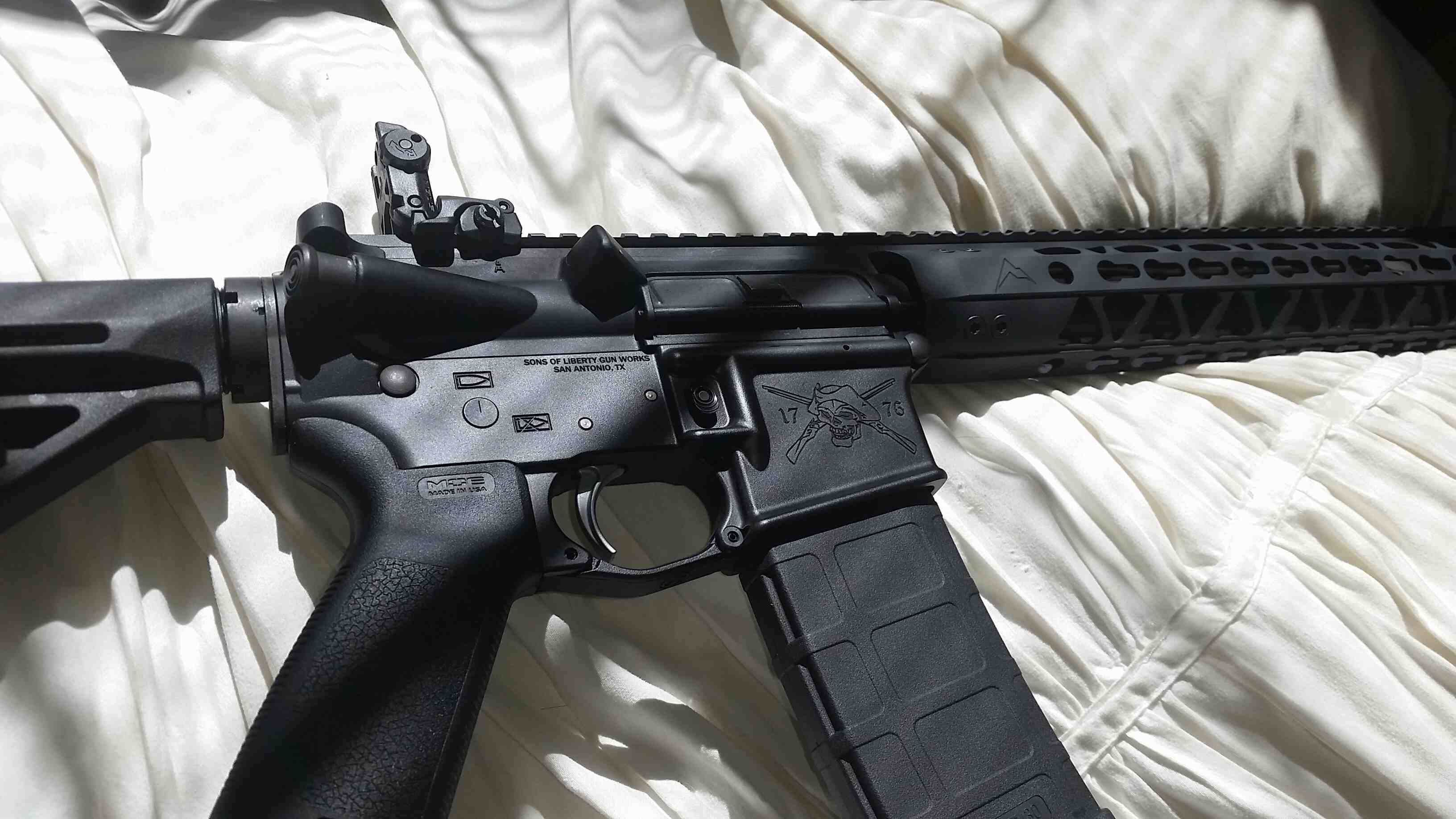

I went with an aero precision upper/lower
15" rainier force free float rail, and a Milspec 4150 CrMoV barrel
MBUS sights
milspec buffer tube
an ALG ACT trigger
milspec BCG
MOE furniture
Built by Sons Of Liberty gun works in san antonio engraved by them
