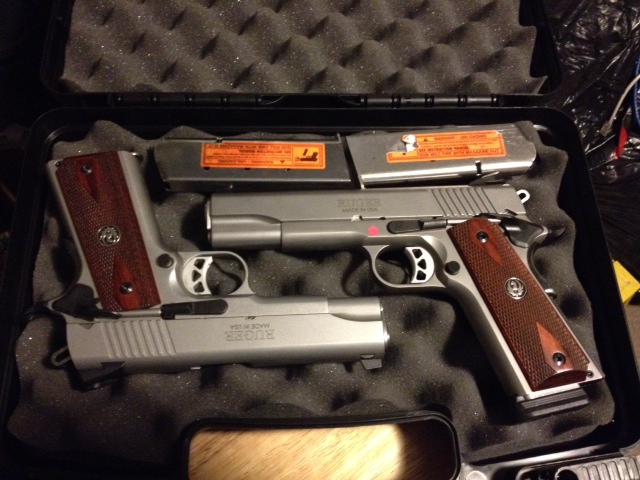

They are great guns I own both the commander and the full size . I've fired hunderes of rounds through both with not one FTF or FTE. Both are easy to clean.
Here is a picture of mine together. You can't go wrong with Ruger's
