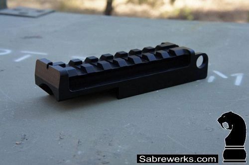

Actually, I found a more versatile sighting solution - the Saberwerks KOP optics mounting system.
It's a complete replacement of the rear-sight block and uses a dovetail to slide on various mounts/sights:
Sight block:
Sliding a base onto the dovetail:
Iron sights:
Short rail with red-dot:
Long rail with scope:

That's an interesting setup. I'm guessing that the lever for the top cover is the locking piece for the two mount halves? Looks like it would be nice and solid. I'll be interested in how it works out for you.
I've used the TWS Dogleg dust cover with their aperture sight before on mine but currently have a AK Master side rail (I forget which rail is latched to it) installed to mount a 3x PA Prism scope. I tended to prefer using just the aperture sight on the TWS vs mounting a full size optic on it as I felt it moved around a bit with the extra weight under recoil - at least my groups were significantly larger in that config.

There's a pin which goes through the hole and holds the sighting-system to the sight-block (and holds the gas-tube in place, too)

The notch has always been annoyingly teeny, even back to when I had young eyesight. The AK could be miles better in that regard and I'm just going to go red-dot (the rail has a built-in - and larger - irons notch, see below) as well as a magnified optic.

My package is finally enroute, expected in 2 days from UT.
For some reason they're out of the short rails for red-dots, so the owner contacted me to ask whether I'd be interested in a slightly longer version that includes a windage-adjustable rear sight. I wanted to see it so he texted me some pics.
When I asked about it appearing to be a non-standard part, he said "It's a non-catalogued item for a manufacturer. He decided not to pay us, so we were stuck with these custom parts." - I figured it was worth a squirt, so I accepted.
Likely putting this together around Thanksgiving - my buddy with all the AK tools is having back surgery soon, so he'll be out of action until then.

He didn't ask for any more money, so the same as the standard part ($92) and I don't know - you could email sales@sabrewerks.com .
This one has 2 addition Picatinny slots over the short.
