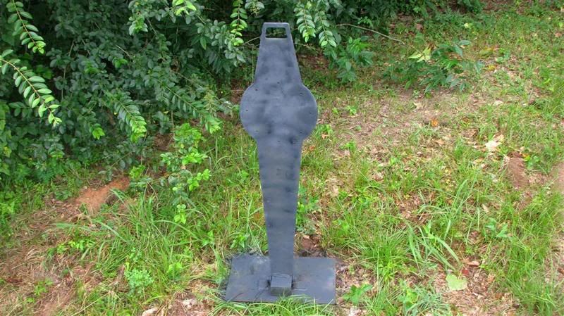

Everyone is familiar with “pepper poppers�, I make mine like this:
Again, the same construction is used for the base ( a base plate with 10� of round stock welded to the bottom). This makes for a quick set up in any reasonable soil (devoid of rocks or large roots).
Humanoids are exact replicas of official IDPA targets.
Continued next post……..

- TexasComputerDude
- Posts: 965
- Joined: Thu May 01, 2008 4:47 pm
- Location: Lufkin, TX
Re: Question about building custom targets.
I agree!
NICE!
Good job on those man.
3/8" mild steel will hold up just fine to .45 acp (I've been shooting mine for 15 yrs, now).
The targets shown in the photos are very well thought out, cleverly designed, and very nicely made. Flintknapper is clearly a highly talented guy.
I wasn't clear in my original post about steel dimpling. My intention was to recommend armor plate material if the targets were to be used for both .45 and centerfire rifle. I agree that properly selected mild steel will work with pistol rounds like .45, .38SPCL, etc.
The frames around the targets in some of the pictures have a few holes and dimples from the occasional errant round. Have there been any ricochet experiences when rounds hit the frames instead of the targets?
